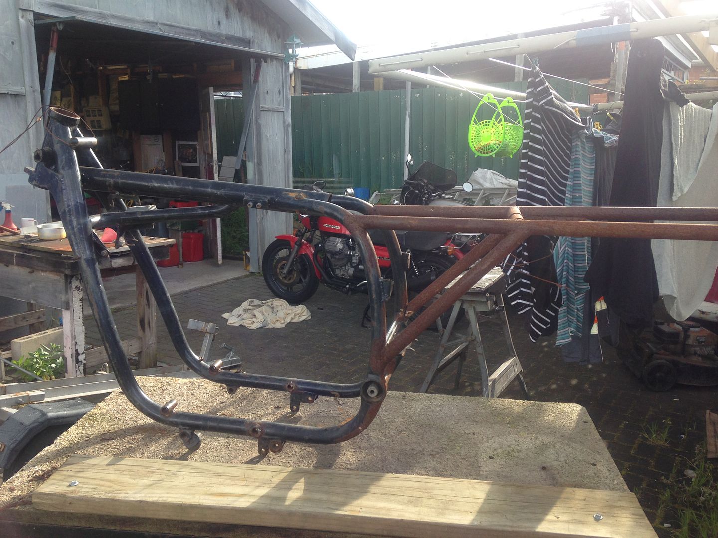

    here is a stock frame I had a go on a few years back after experimenting with some Chrome Moly tube, trying out gas, brazing, and mig then whacking them with a hammer to see which was strongest.
    Started on the frame then went for stock which I have been using on the track for about 3 years.
    Note engine position was going to be moved forward and up.
    When you see that the stock BMW sub frame is held on with 4 8mm bolts you have to wonder if doing welded joints could be any worse.
