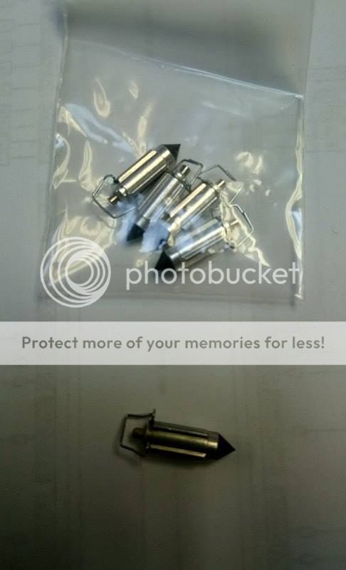

    so finally FINALLY these bad boys arrived!
    http://i881.photobucket.com/albums/a...sc8fmv0cv.jpeg
    Just noticed I didnt actually post an update to what was wrong, but we discovered that the float valves had rings on the rubber points (dont know the technical terms haha)
    so measured up the originals and ordered these from China. Quality looks pretty good. Won't be able to throw them in and set up the carbs correct this weekend as the racecar is going in for some major work so will probably have to just sit tight and wait till the following week after work or something
    fingers crossed this sorts it (or at least gets us significantly closer to completion!)
