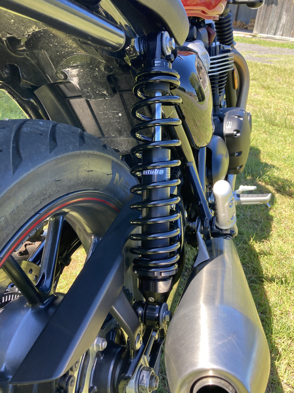

    Bought some Bitubo shocks($900) for my Street Twin via eBay back in September. Couldnt afford Fox or Ohlins $1000+
    They arrived yesterday.
    Fitted them today and will make some comments after some use.
    There are several versions of shockabsorber offered by Bitubo the ones I got have adjustable compression and rebound.
    Springs are tailored to my riding weight.

    18th November 2021, 11:321/32 man
    Thanks for that, I would agree.
    I have had one ride and felt the bike was more stable when riding lumpy corners.
    I also think I need to crank up the springs a little....is that rebound or compression?

    rebound and compression is referring to the damping, not the springing

    The shocks are adjustable at the top with a little lever and at the bottom of the spring/shock body using a C spanner.
    After a first ride and what I assummed was the shock topping or bottoming I wound the spring preload up using the C spanner. The top lever goes from soft to hard and I put this in the middle......ride seems good, betterer even than the stock shocks.
    I bought them via eBay as I had funds in my Paypal account waiting for something like this. It was click and wait. They came from Italy and I was sceptical at first as not much seemed to change on the info page but then after ten days they were shipped and I received regular email notifications as they moved across the globe....about five weeks.
    Since this picture was taken I have added a black bobbin to the top shock mount as a luggage tie down point.
