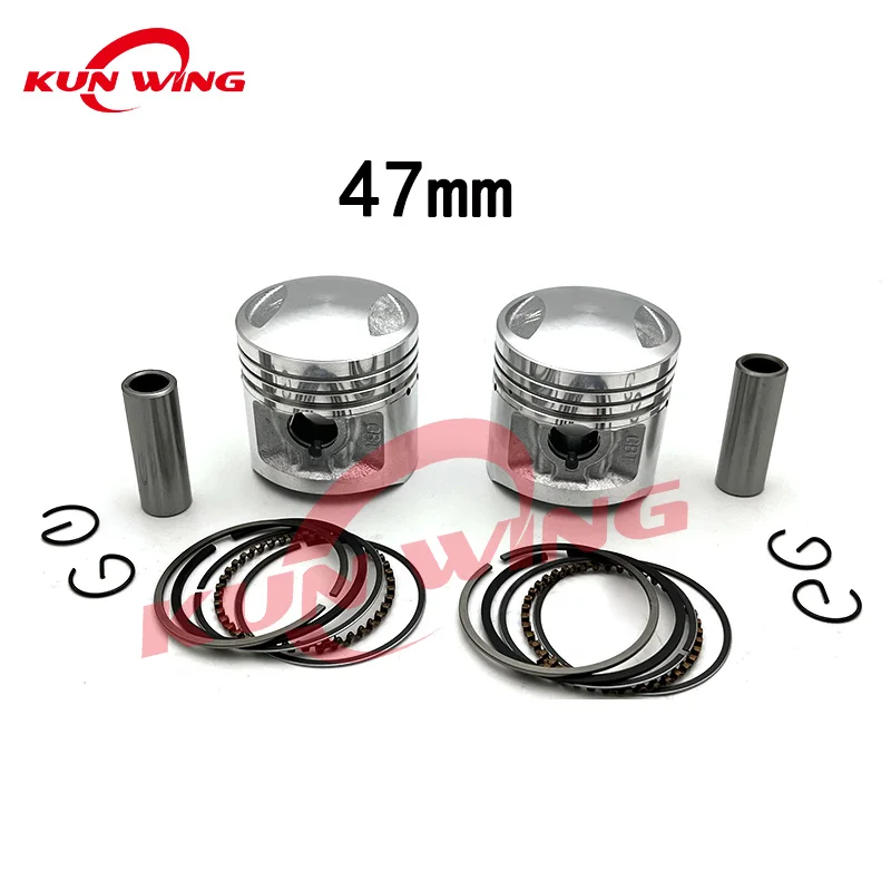

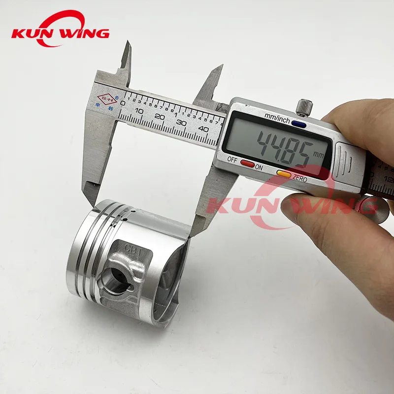

    Neil, C90 12v ie late is a dished piston in suitable size pin is 13mm but petty sure you can fix this at the piston or the rod,
    FZR250 is 14mm

    I need raised top pistons, the 250 combustion chambers are rather large.
  4. #34
    12,366
    the earlier ones are domed. there is also a flat top c70.
    so just how big is those chambers.....
Name:	high comp 47.PNG
    i guess with ethanol you can have decent comp

    And those ring grooves suggest 6000rpm.
    He's the only one I've got.
    They look to be similar to the cb125T widths?
    in my defense Rootes blowers make power at low revs anyway.
  7. #37
    F5, that's rubbish. Get your facts right. They suggest only 5900 rpm...

    FB80 Suzuki
    1mm rings 13mm pin
    FB80 1 85 shape 48mm 44mm pin length 21.7+1 comp height 1.0-2 comp 2 oil 13mm
    or CB150T
    CB150T 1 104shape 47mm bore std 48.5 pin length 20.7+4.3 comp height 1.0-2 rings 2 13mm pin 38
    pictures here
    or CB350F
    Honda CB350F 47.50 23+4 13.00 53.00 13103-333-000
