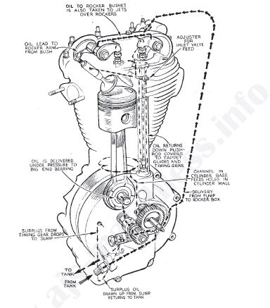

    My first speedway bike had a J.A.P 4b engine which may even predate the Enfield. Engine oiling was via a dual plunger pump ('pilgrim") one feed to the crank and the other to a trough in the rocker box (between the pushrods). A hole in the side of the valve guides aligned with a drilling in the head, which was gravity fed oil from the trough via a small pipe. Feed to the rocker arm needles was splash from what ended up on the top of the pushrods. Would appear that guide oiling was more positive than to the rocker arm bearings

    looks like AJS twins and singles had a direct metered feed to guides as well
    https://www.accessnorton.com/NortonC...il-hole.31151/
    https://forum.jampot.com/viewtopic.php?t=26382
    right back to vintage
    https://www.vintageajs.uk/2021/06/th...on-system.html
