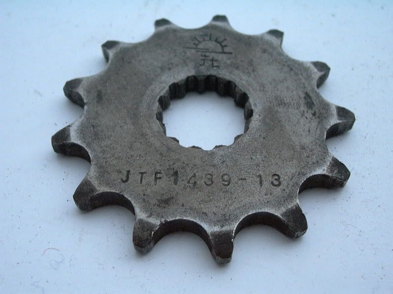

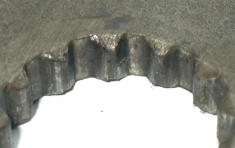

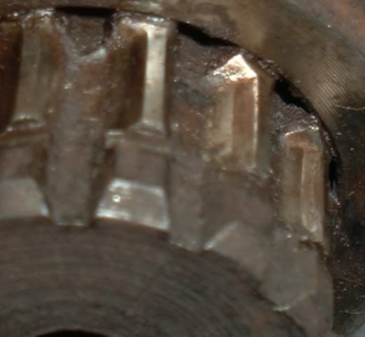

    Here are a few pics, see what ya think...
    http://i21.photobucket.com/albums/b2...0/P1010800.jpg
    Drive Spline
    http://i21.photobucket.com/albums/b2...0/P1010803.jpg
    Front Sprocket
    http://i21.photobucket.com/albums/b2...0/P1010805.jpg
    Front Sprocket
    http://i21.photobucket.com/albums/b2...0/P1010807.jpg
    Rear Sprocket
    Im probably being paranoid, the more I look at it and the more I move it on the spline drive the less concerned I get.

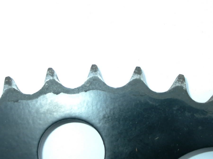

    Sorry to say it, but it looks worn to me.
    Take a look at the attached photo of the sprocket, I've circled bits on the sprocket where the edges look like they've been beaten and kind of pushed out to form sharp-ish lips. I'd say the odd shaped shoulders on the spline are also due to wear.
    It looks like it's the right sprocket though:
    http://www.jtsprockets.com/61.0.html...tnr=JTF1439,13

    Ah well, guess its time for some new sprockets and chain.
    Ill do a bit more cleaning on the spline and see if they are wear marks or its machined like that.
    That's a very badly worn mainshaft spline,damn near half worn away! Bad news is it's a total engine strip and the shaft is not cheap new,and possibly hard to find 2nd hand.
