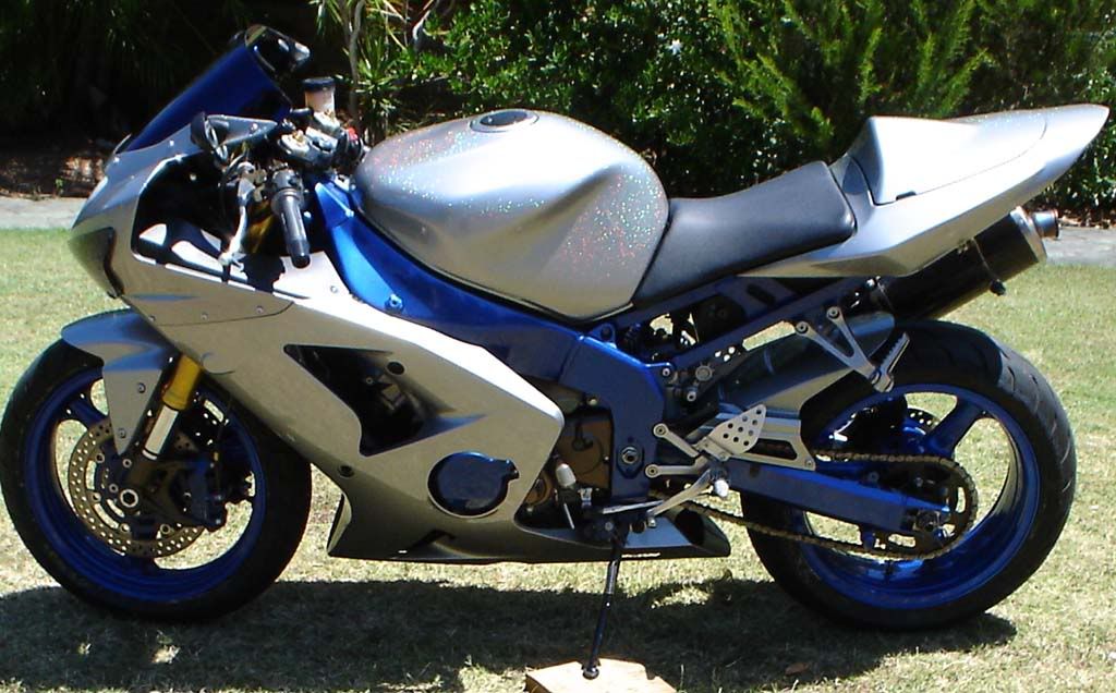

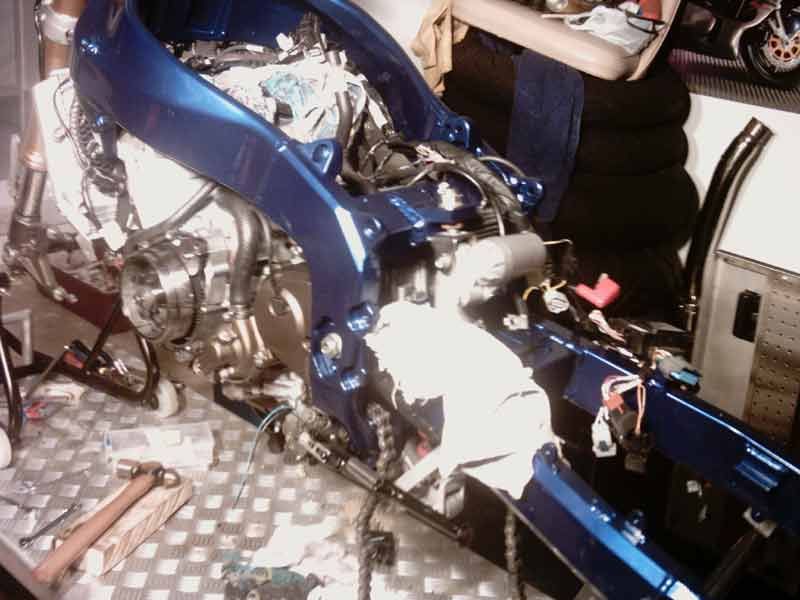

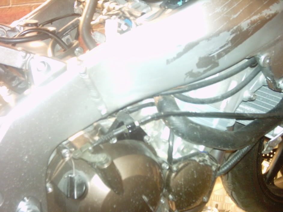

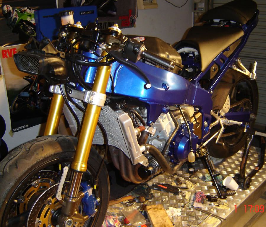

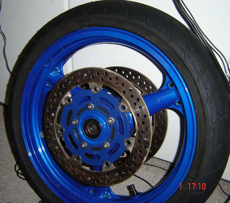

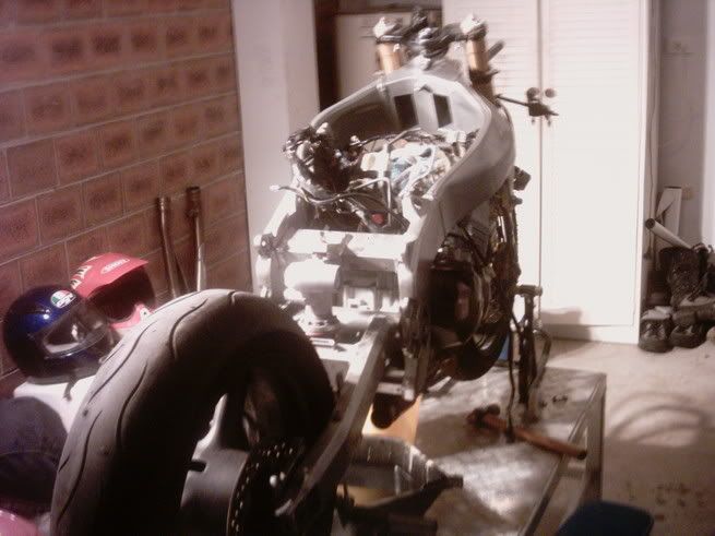

    Hi,
    Powdercoating one set of my wheels had an amazing effect, I painted the frame and fairings/tank but the effect wasn't as good and there is so much contact/rubbing on the frame it is coming off too easy
    My ZX6 teardown took 3 days, and the rebuild another week, once I had all the parts back, which took 2 months almost.
    Can someone go into more on the caliper powdercoating, how do you stop the interior of the calipers from being coated over and how does it hold up against heat?
    I don't want to flood this thread with photos so below you will find;
    Bike before teardown
    Crap condition of frame before
    Stripped
    Frame and shocks only
    Coated wheel
    Painted frame
    Almost assembled
    New shift light LED, its 14,000mcd, can't miss it if you want toot now
    Finished
    Feel free to ask any questions I can help tons if needed, made some tools up to do some bits here and there, also uses kawiforums.com a lot
    Side note, my bike came out with the silver frame, the black frame is easiest way to tell the 04's
    >< The little ZX6 that could ><
