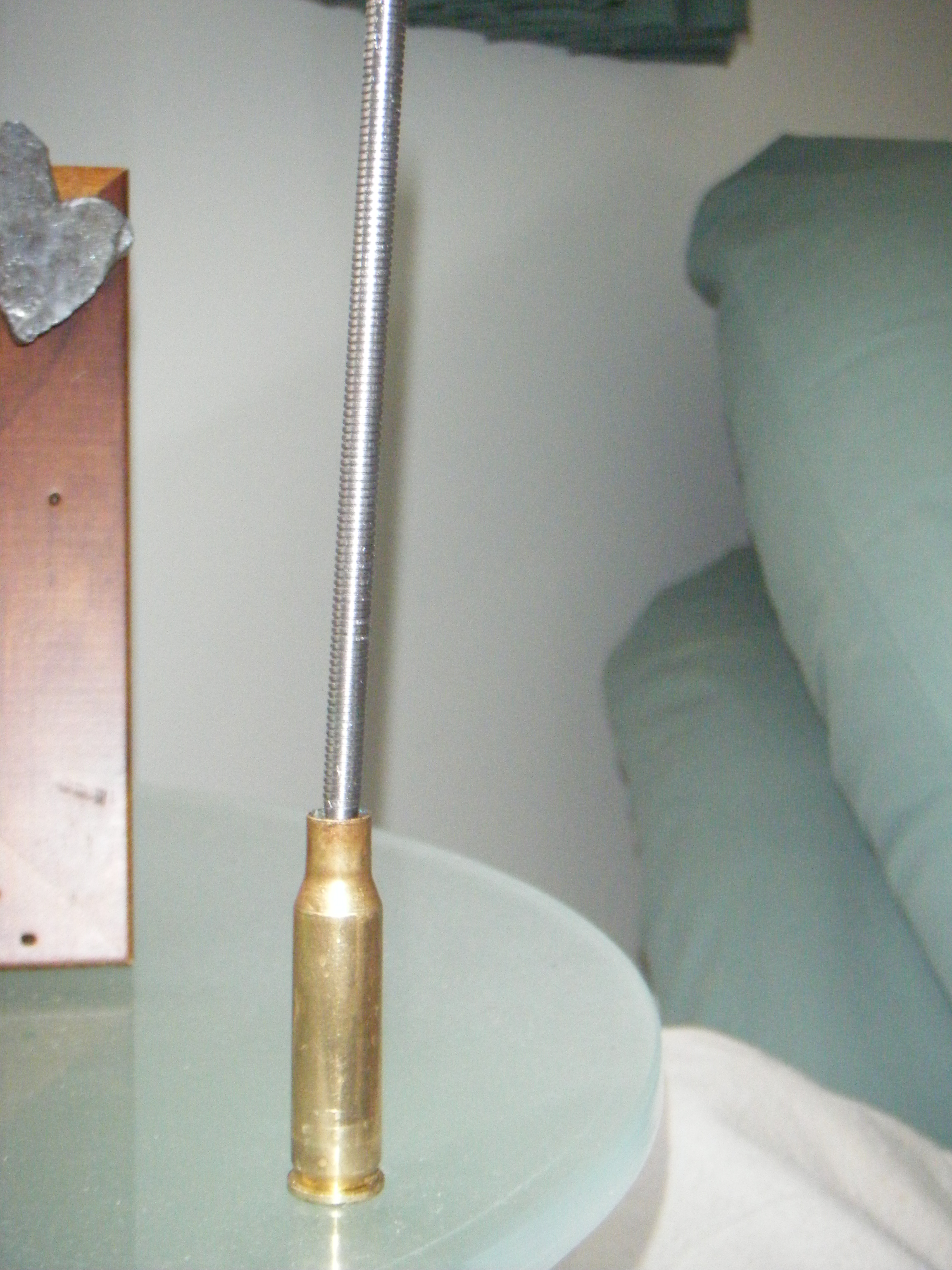

    so i resized 2 cases when this happend
    http://www.pyrocam.com/filez/go/DSCF3585.JPG
    http://www.pyrocam.com/filez/go/DSCF3584.JPG
    http://www.pyrocam.com/filez/go/DSCF3587.JPG
    its the sizing die bit that pops the primers out - its stuck.
    what caused this and how to get it out?

    indy sorted me right, aparntly the locking nut locks it in.....

    Quote Originally Posted by renegade master View Post
    I had similar problem a while back and the cheapest solution was to hacksaw the case in 1/2, unscrew the priming pinholder/internal neck sizing thingy on the bottom of the zip thread, and pull the Hornady pieces out from the now destroyed 308 (or 270 WSM in my case ) brass
