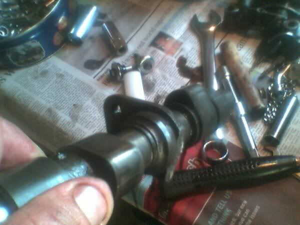

If you want the two bolts that I made then PM me with your addr and I will post them. I swapped the originals back in so only have my custom ones that had to be ground down at both ends to fit.
thanks but i rescued one & got a second one (to replace the one that fell out in the first place) from the wreckers where i got the cam
props to Action bike wreckers, barrys pt rd !

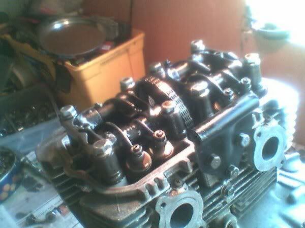

i have pics of the job thus far... should i post them here or make a thread somewhere more appropriate?
Ah just post them here -- this can be the gory rebuild thread
Sweet, sounds like you got off lightly then. Sourced a new camshaft? Or was it just the bolt that broke? Valves OK -- didn't hit the pistons?
Get some cheap oil (car oil, doesn't matter) and flush the oil through a few times before starting the engine. I pulled off the side cover to scrape out most of the swarf. When you first fire up the engine, idle the engine for 10 minutes or so in the garage, then do an oil change. Do it again if you like. Then do an oil change within 500kms. I did that and my bottom end seems to have survived.

Aligning the cam to the crank should be easy. You just get the engine at TDC on the compression stroke -- there should be an inspection plug you unscrew that will show you index marks on the flywheel to get there. Usually a `T' mark on the flywheel rim. Then the camshaft, once it's bolted up to the cam sprocket, there will be a pair of index marks on the sprocket as well, or something like that. Align these with the gasket face, and you're all done. Slightly complicated by the fact it's a twin, but they've got index marks for a reason.

i have the head sitting on, i got out the piece that went into the engine
also, thankfully because it was a clean break, theres no shit in the engine

its finished BTW, about an hour ago
it run... i think i need to reset my exhaust valve clearnaces though,... bit noisy
