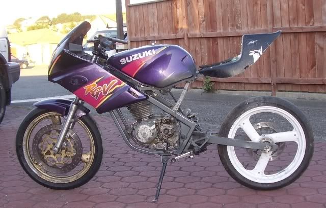

    I've now got the tank and seat solidly mounted. Quite happy about that.
    I made an aluminium plate for underneath the fibreglass seat unit and adapted it to the frame.

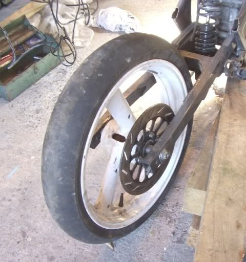

    I've done more to the bike yesterday afternoon and today.
    Re-braced the seat unit underneath and tidied it up the rear tailpiece.
    We've now procured Ivan's slicks which I had a go at putting a front one on myself but without much luck so shall get the bikeshop to do so tomorrow.
    Spent today machining the original RGV front disc to become the rear disc for the TZR rear rim. Only using 4 of the six bolt holes required, as it's sufficient.
    The disc is a little on the large side but should be fine.
    So getting there bit, by bit.

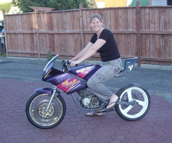

    Couple more pics, one with the Supermodel Mrs Nudie :
    Photobucket
    Photobucket
    slowly coming along....

    looking good!! Cool jandals mrs nudey!!

    funnily enough she said..."oh my god you've got a pic of me in jandals !!!!"..

    Further update again.
    Got a sprocket from a generic Yamaha trailbike and would you believe the bolt holes lined up perfectly with the disc bolt holes on the rear rim. I was concerned I'd have to modify but not needed.
    It's so pleasing when something goes together so simply.
