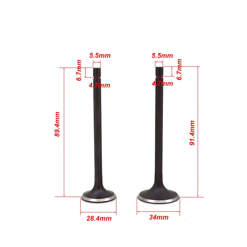

    The engine is back together and in the bike. I'm planning a small job on a water pipe and it will be done. I have gone ahead and ordered a stator I found that is close to, if not exactly, what is needed. I ordered valve guide seals at the same time. Funnily both were listed as being for TTR250 motorcycles.
    A very quick google suggests 3.5mm stem for FZR and 5.5mm for TTR250?
    https://en.impex-jp.com/catalogs/mot...-s-101445.html
    https://www.partzilla.com/product/ya...HX-12119-00-00
    looking at the fiches here it seenm the 2kr ones are the same s yzf600

    This is the listing: https://www.aliexpress.com/item/1005...60fd4c4ds4J7JV
    16 valve stems in the set so not any TTR250 that was ever brought to NZ. Cheap as chips so worth having a look.

    Oh well, it was still worth checking out. They fit 4mm stems so will be good for the 2KR version.
