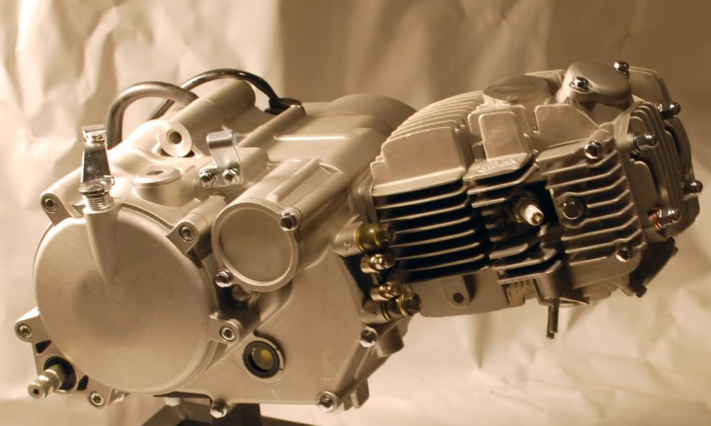

    You could always put a pitbike motor in it.
    Seriously, I know you guys like the 2 smokers but that thing would weigh about the same but have lovley handling, and the pitty motor would be quite light with lots of low down grunt to pull it out of corners.
    A cheapie would be getting a $200 pit bike and using the motor out of that.
    But hand off my one! I still need it and mikey has buyback rights.
    The ideal would be a 3 valve head one or 150cc job but they would cost a bit more than the still workable 110 cheapies.
    Brand new 110!
    Brand new 125 but out of stock.
    140cc on trademe (too expensive)
    http://www.trademe.co.nz/Trade-Me-Mo...-155394409.htm
    That is what I would look at anyway, Of course if a good priced H100 or whatever comes up that would probably be far better.

    Well, you can get a brand new Loncin 145 engine with a carb for $600.
    The only issue you have is putting it into a frame originally designed for a 2-stroke. Carb sits high and the the tank has to be adjusted to suit.
    But it can be done, hence Lady P & Brains

    A pitbike is not strictly speaking bucket legal. It is supposed to be roadbike engine. Not that we'd probably care too much, but they are varied quality. mostly not quality.
    Also the bike is set up to slot an MB100 engine straight in. Anything else is more fabrication. + an MB is a better engine than most else.
    He's the only one I've got.
    Now that Ive seen the bike in the flesh (or metal?!) I understand better!
    H/MB 100 it should be. direct swap = soo much easier.
    Does it count that the pitbike motors (mine at least) are a blatant copy of a CT110 honda?

    Depends I guess, the rules weren't written to cope with that. If it was a CT copy then I guess no one would care, just as the Lonchin is a copy of the GL.
    But it gets complex as people could then buy all sorts of crazy hop up parts that were popular for pittys & racing cranks, big bore kits, special heads etc would not be legal.
    I don't think anyone really cares if it is a copy of a legal engine.
