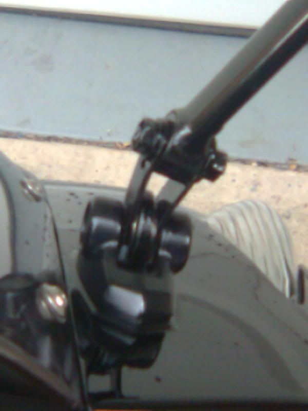

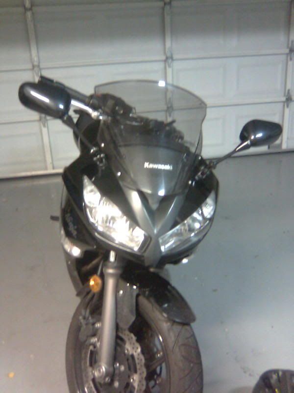

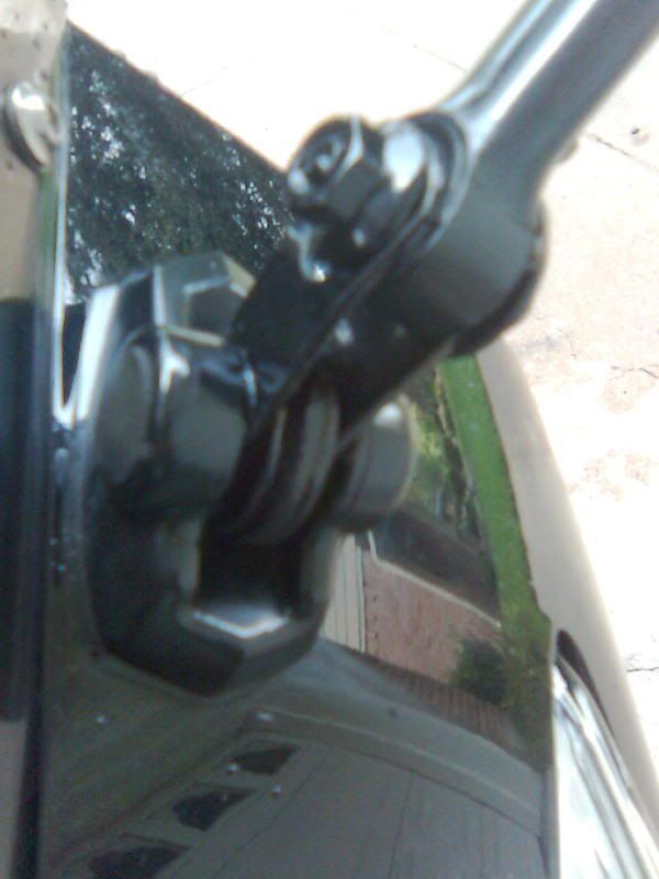

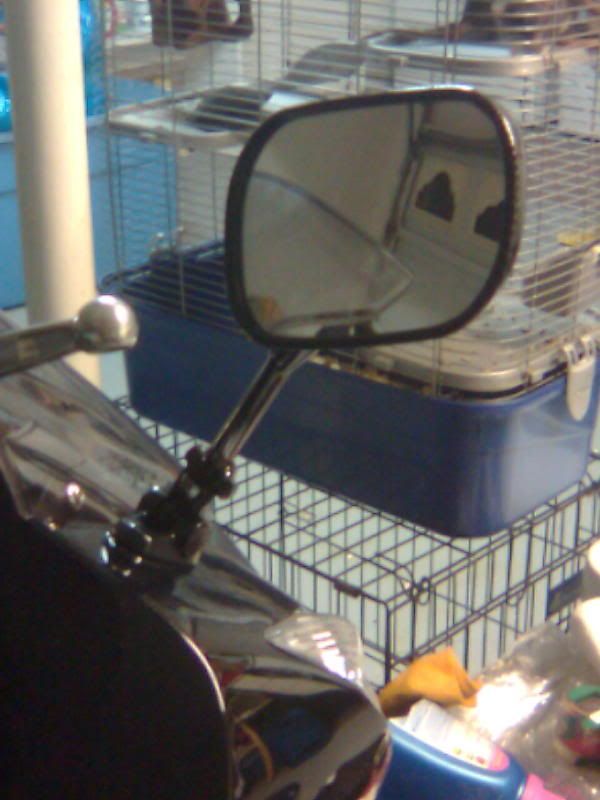

    I'm too cheap to buy the mo-tech extenders. At 60 bucks, could you blame me? I made the set of DIY mirror extenders using metal plates, stacked washers, and extra nuts and bolts I had laying around. Most of the parts came from the local walmart hardware department. Then I painted them black to match the bike. Parts were less than 5 bucks. If I drop the bike... the extenders bend.. just bend them back. I might make a rubber boot to cover the whole thing. You wont notice them unless you had a good hard look.
    Parts:
    You need plates similar to those found in a Walmart U-bolt kit. I found these in the hardware dept. but the plates were longer and not as wide. The U-bolt in the kit were not used.
    washers - I bought the assorted variety.
    nuts and bolts
    Assembly:
    Step 1: Sandwich the washers between the plates and then connect to base of mirror.
    Step 2: bolt other end of plates to mirror.
    step 3: paint to desired color.
    How does it look?
    sorry bout the quality, it looks better when zoomed out
    looks like part of the bike.
    I'm surprised no-one has thought of this or bothered to post it. People must be making millions off of us rich bikers.
    It's a simple and cheap fix for a common issue. I was worried about vibration issues but I didn't have any.
