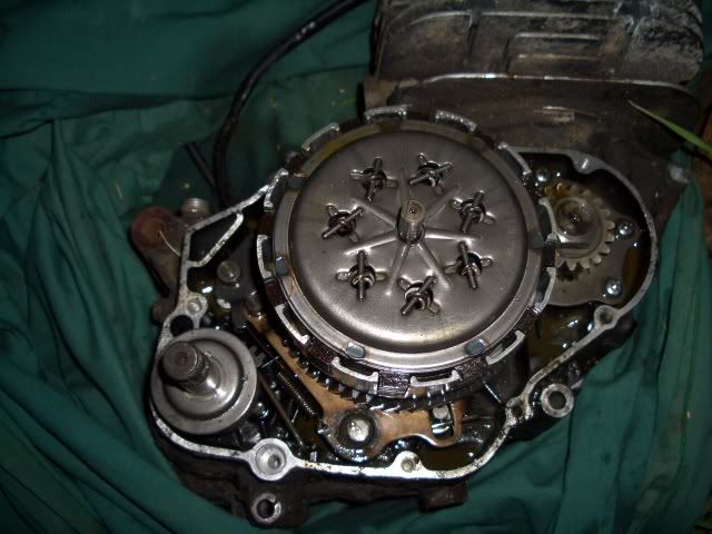

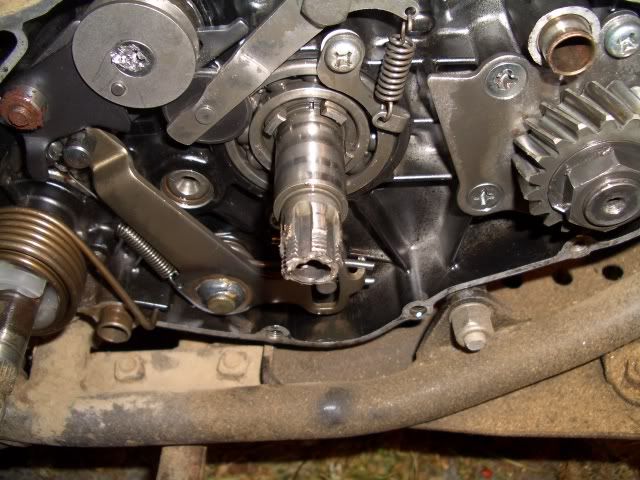

    Last weekend I was donated a complete motor/box for parts, so started by stripping the cover off tonight to work out how deep I had to go to swap the parts over, I have to swap over the complete clutch pack and the gear behind it (and possibly the shaft they are on as well).
    Does anyone have a copy of a workshop or parts manual for one? I just need an exploded view so I can work out how it comes to bits, or advice would be fine as well.
    I'm not a novice but would be keen on some advice so I don't have to learn by mistake.
    Here is a pic of the area of the donor motor I am talking about.

    And a pic of the original motor still in the bike showing whats missing.
    Photo Sharing and Video Hosting at Photobucket

    Awesome, thanks for that, can you explain how the outer cover for the clutch pack comes off? It has a series of springs visable in the pic I posted, do they need to come out? or is the centre shaft the first thing, if so how?
    20th November 2002 - 03:11
    Registered. For now...
    Tauranga
    1,627
    First, read this thread.
    Once you have the plates out, the rest should be obvious. If you are not sure of things, take a photo of each bit before you pull it apart. Digital cameras have many uses...

    Update time.
    I now have a 1980 TF/TS 185 Suzuki
    I decided it was a hassle to strip the whole case to swap one shaft, and the TS case that I got as a donor, had the tacho drive already in the case.
    It was just a simple swap of the barrel and piston off the TF onto the TS case.
    After I had put the clutch back together on the TS anyway
    So it's up and running again, but without electrics, more on that in another post under the electrical section
