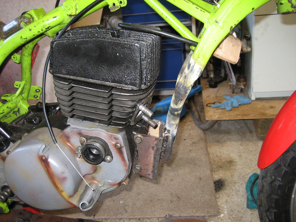

    I thought the GP100 & GP125 bottom ends were essentially the same but looking at that photo they're quite different.

    I've just been tinkering and have realised that what I thought was different probably isn't different on a stock version.
    On my GP100, the casing around the carb has been cut away, on further inspection tonight, it looks like the casing for the airbox has also been cut away. The bit that looked different was the bit with the sieve attached to it.

    GP100 and 125 bottom ends are much the same just different carbs 22mm for the 100 and 24mm for the 125. Different rotary valve timings which can easily be changed and the rotary valve cover on the 100 has a slightly smaller inlet tract which can be opened up to suit the 125. Everything else on the bottem end is the same. I did try a 125 rotary valve in a 100 once but it made the 100 motor very peaky.
    I've been thinking about putting a 125 rotary valve in, but may just alter the existing one. I've got an spare uncut case which I suspect is off a 125, the inlet tract looks bigger in diameter than the one on the motor at the moment. I'll have to pull it off and compare them.

    The first part of the GP's engine number on the crankcases should tell you if they are from a 100 or 125.
