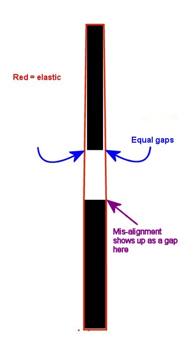

    Don't trust the swingarm marks
    Here is the way a racer showed me. I've spent hours and hours trying different methods ... this one is quick, easy and 100% accurate
    The trick is to get a card of elastic from the super market and stretch it around both wheels. You need to make it as tight as possible so it holds a straight line. Because the back tyre is wider than the front there is a gap between the elastic. Make sure this is equal on both sides of the front tyre. Any mis-alignment will now show up as a gap between the elastic and the front edge of the rear tyre.
    It should look like this
  4. #19

    Quote Originally Posted by Oakie View Post
    Ouch! Yeah I had a feeling from when I was a biker in my youth that you shouldn't trust those marks without question. Cheers
    I completely agree... Don't trust the swing arm marks they are bollocks... go for the string. (Beware the "gap" method though as this allow a margin of error dependent on the back tires size).
    NOTE: you only need to do it every so often because once aligned you should just count turns on the adjusters for most chain tensioning exercisers.
