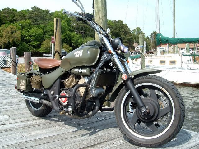

    MODEL YEAR 2006'
    http://i299.photobucket.com/albums/m...lladcha2pl.jpg

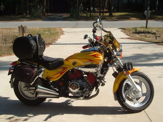

    MODEL YEAR 2004'
    http://i299.photobucket.com/albums/m...iker/obx32.jpg
