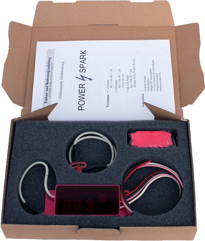

    Ignition
    Another subject for the party-people...
    I've ordered one of these for testing:
    CE-i 100 with sensor SE-1
    http://www.power-spark.de
    Manual here http://www.power-spark.de/downloads/...ngl_2011_1.pdf
    Seems like a good unit, has it's limitations, but for my use (variated engine) it should suffice.
    Some features and limitations:
    - 4 programmable ignition maps (and 10 preprogrammed maps - non of them seemed very useful, maybe for small rc engines)
    - no computer needed, programming is done with a magnet(!), seems slow and weird but hey, no computer needed.
    - Four adjustable rpm-points only (actually just three, the first point has to be 0rpm), this is very limiting for most, but for my variated setup it's ok.
    - Easy setup; there's a "sensing mode" where it notifies you when it senses the magnet - just lock the crank at 75° btdc (what the manual say's it should be) and rotate the flywheel until the magnet is sensed - tighten up, done. If you manage to fuck up, you can adjust the 75° to something else, but anything under 75 limits how much advance you can run at high revs. (they give an example; if you set it to 70° btdc you can "only" run 35° advance @ 26500rpm, yeah thats gonna be a problem.)
    I also asked Ignitech what they would charge for a dccdip modified to be used with an hall sensor - same price as the regular unit. So if this Power-spark is no good, I'll just get the tried and true Ignitech, and reuse the hall sensor pickup.
    I'll post a small review when I get it up and running, if anyones interested.
  5. #16685
    18th May 2007 - 20:23
    10,592
    Interesting Ignition, I would like to know how it goes when it is up and running.
