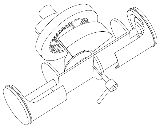

    Hello Husaberg
    The volume above the exhaust ports (post #9172):
    seems difficult to be scavenged (lots of residual gas).
    Reasonably it will operate much hotter than the conventional 2-strokes.
    The exhaust valve:
    is simpler but, as the sleeve valve, has several issues: hot (it is a metal grid, like a radiator, through which all the exhaust gas passes, it abuts heavily – and moves at the same time - onto the cylinder head, it requires sealing means at various points, it requires strong actuation mechanism. What about the spark plug?
    Here is an unconventional rotary valve:
    (more at http://www.pattakon.com/pattakonPatRoVa.htm )
    The compression –combustion – expansion pressure loads heavily two opposite surfaces / fronts of the rotary valve. But the force on the one front counterbalances the force on the other front (through the hub) leaving nothing to the bearings.
    The lower cylinder wall can be full of ports (transfer or exhaust, depending on what the rotary valve is for).
    For asymmetric intake without reed or disk valves, the PatATi approach can be used:
    Youtube video at http://www.youtube.com/watch?v=aXvRaVqiHxs
    (more at http://www.pattakon.com/pattakonPatAT.htm )
    In the PatATi a properly shaped connecting rod in cooperation with a properly shaped piston opens and closes asymmetrically intake ports on the cylinder liner.
    The PatRoVa rotary valve better fits with 4-strokes:
    Youtube video at http://www.youtube.com/watch?v=6Q-EGdeS0ws
    (the underneath mechanism:
    shwon better in the following drawings:
    is unconventional only because it was available when the PatRoVa prototype was made.
    (before reading at http://www.pattakon.com/pattakonPatTwo.htm think what the trottle with the lever in the last drawing is for).
    Objections?

  14. #19199
    12,285
    Quote Originally Posted by manolis View Post
    Hello Kiwi
    Hello Husaberg
    The exhaust valve:
    Objections?
    Questions?
    Thanks
    Manolis Pattakos
    The Grate sliding valve was a muse
    I could not be worse than a poppet valve and look what they have been developed into.
    I do really enjoy your animations.
    That cutaway piston I posted was actually raided from one.
    This one I do like. but maybe with the top end crosshead guided?
ID:	315138Click image for larger version.
    The rotary valve prototype is interesting not unlike the Coates and the Aussie (Deane) only done differently.
    The prototype engine is fashioned/fabricated together in the manner of the Autounion f1 engines. neat
    I do like the creasy engine Why?
    Because after only a few rushed years they were better and more reliable than a conventional engine development only stopped because the turbines were better again.
    With some devolvement R&D and modern metallurgy who knows.
    I added it in as I could see no other reason for the "Twist" in Ryger
