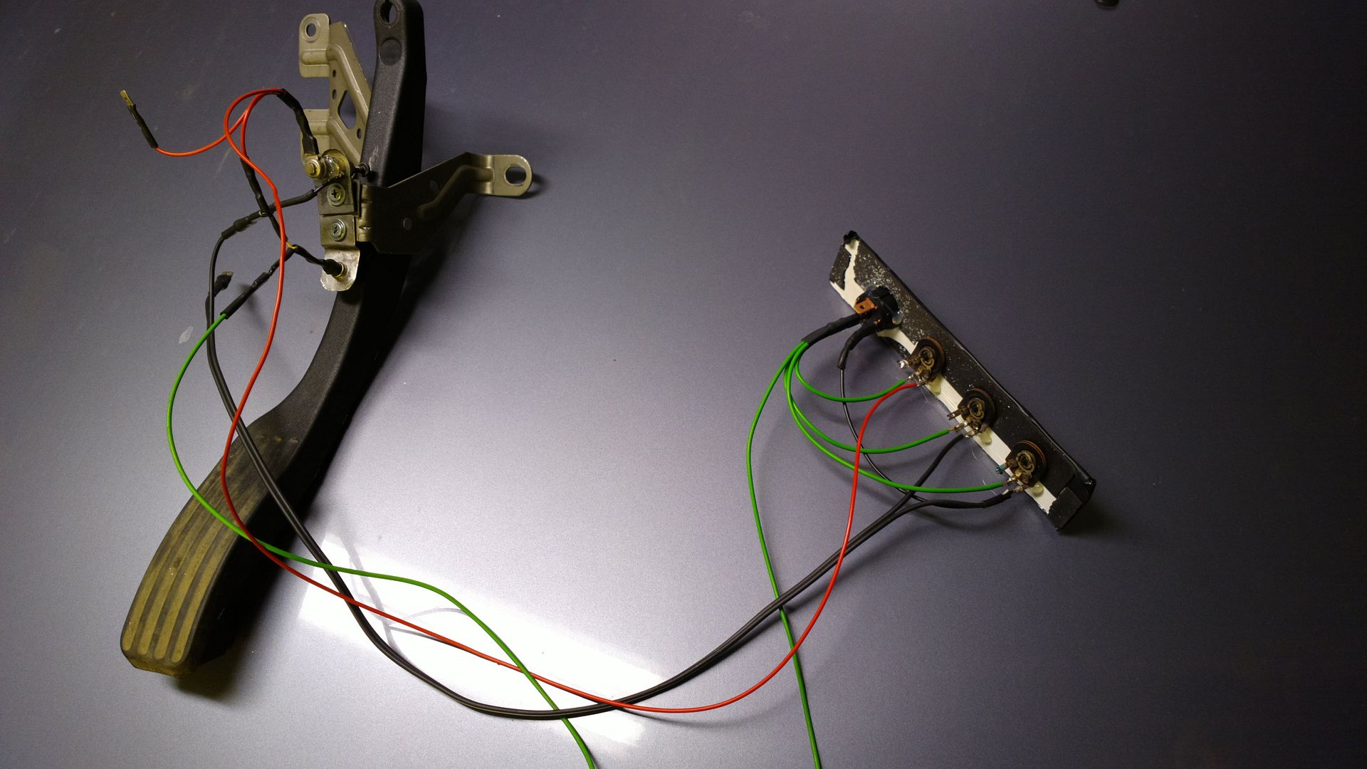

    Has anyone tried E85 in their 2 stroke?
    I tried it in a 250cc 4 stroke single, it was worth almost 2hp. But I didn't spend the time to truly optimize jetting, so it was temperamental, and lost interest
    I have, same story as you, gained power but was temperamental. Didn't get to play much with it cause the urge for further modification got in my way, it usually does...
    We have tried and used RE85 somewhat alot in Finland. Our booze moped is 79cm^3 air cooled lazy 2-stroke Suzuki. RE85 gives enormous (not sure if you can say that ) amounts of low end torque, or shall I say toughness. It's not very well shown in the dyno graphs, but in real life the runnability changes dramatically, engine tolerates rpm's much lower than idle when crawling in forests, throttle response is better and it doesn't care if you slam WOT at very low rpm's. The engine runs much cooler too, and tends to be less sensitive to spark fouling. Good functionality required only jetting. After those dyno graphs the ignition advance was turned a bit earlier, leading to better overall curve and max torque/hp.
    Blue is 98 octane gasoline, with 5% of ethanol in it. Red and greenish are RE85 runs. Red curve is at normal operating temperature and greenish is intentionally overheated pull. Only difference was the change of fuel and jetting.
    Our RE85 moped: https://youtu.be/gt6gUc91nWA
    Another RE85 moped, con-rod failure: https://youtu.be/x7kXIHxhMfw
    And sitkuura's RE85 Race-Suzuki's dyno charts (last message on that page, you can try google translate if you want...): http://www.pv-foorumi.org/viewtopic....0472&start=208
    We have used 3,5% of Shell Racing M 30 with RE85. Works well, stays mixed even in the middle of winter. Here's also some kind of test raport (4th message on page, unfortunately in Finnish): http://www.pv-foorumi.org/viewtopic....=9705&start=13
    E: We have also made couple of DIY RE85 car conversions. Only required some ECT data manipulation with potentiometers. http://i893.photobucket.com/albums/a...psjhxjdwrl.jpg
