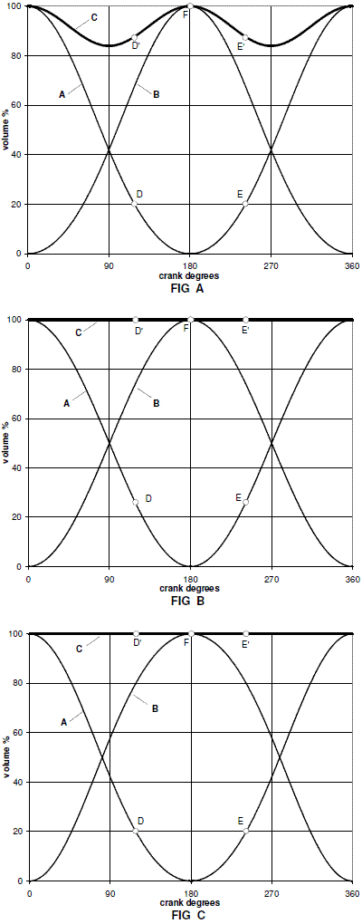

    Hello all.
    Quote from the post #23,190 of Frits Overmars (July 12, 2016):
    “I had a pleasant exchange of thoughts with CITS-inventor Basil van Rooyen (picture) last year. I think I did comment on the CITS engine before, didn't I?”
    I searched but failed to find anything. Any help?
    In a couple of months it is to be granted the UK patent for the PatTwo engine:
    With a single piston and conventional kinematic mechanism it makes better what the CITS-engine tries to achieve with its two pistons (for more: http://www.pattakon.com/pattakonPatTwo.htm ).
    Depending on the angular displacement of the “yellow” throttle valve, the engine “feels” as having from a quite small “crankcase dead volume” (the two spaces inside the piston are isolated) to a huge “crankcase dead volume” (the two spaces inside the piston communicate freely, i.e. as the piston moves towards its BDC there is no increase of the pressure in the space just under the piston crown).
    Here is the “harmonic version” of the PatTwo:
    It doesn’t need other throttle valve than the “dark” throttle valve in the middle of the cylinder (that with the yellow” lever).
    The crankcase can be isolated / sealed (“purple” separator) from the space(s) “under” the pistons.
    In comparison to the CITS Vee engine wherein the total volume of the space underneath the two independent pistons cannot help vary during a crank rotation (FIG A, curve C):
    in the PatTwo the total volume underneath the piston(s) is constant (curve C in FIG B and FIG C).
    Think what this means for the light loads and the idling (for instance, can the CITS operate without an external / additional throttle valve?)
    Take the Harmonic PatTwo of the above animation and think what is the “crankcase compression”.
    When the throttle valve is completely open (i.e. the two spaces, one under each piston, communicate freely), there is no “crankcase compression” (the ratio of the total “crankcase” volume to the dead volume of the “crankcase” is 1). It is like having an infinitely big crankcase in a conventional 2-stroke.
    When the throttle valve is completely closed (no communication between the space under the one piston and the space under the other piston), the crankcase compression can get too high (it can get substantially higher than in any normal 2-stroke).
    In the intermediate positions of the throttle valve, the actual “crankcase compression” appears something between the above two extreme values.
    To make it simpler:
    when with the throttle valve partially open the top piston crown moves towards its BDC with the transfer ports still closed, a part of the charge previously being into the space under the top piston crown passes to the space under the bottom piston crown so that, when the transfer ports open the quantity of the fresh charge under the top piston is reduced, etc, etc.
    With the throttle valve completely open, the engine idles and the pumping loss is eliminated (like in the Atkinson - Miller cycle (Toyota PRIUS etc) in the 4-strokes).
    As the throttle valve closes and the revs increase more and more power is provided .
    When the throttle valve is completely closed and the revs substantially high, a local peak of power happens.
    In case of tuned exhaust, the engine can provide even more power at even higher revs with the throttle valve completely open, i.e. as open as in the idling!
    Follow the animation and think how this happens: a good part of the charge that enters into the top cylinder comes from the intake port of the bottom cylinder.
    It may be confusing, but think how much it can change the way the 2-strokes operate.
    As for the kinematic mechanism of the PatTwo Harmonic (you can see photos of it used in the PatRoVa rotary valve project at http://www.pattakon.com/pattakonPatRoVa.htm ), it achieves to give perfect balancing of all inertia forces, inertia moments and inertia torques; .in simple words, the Harmonic PatTwo is as vibration-free as the Wankel engine.
    Thoughts?
    Objections?
    Thanks
    Manolis Pattakos
