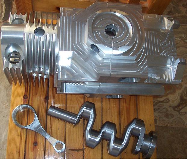

    Hi Manolis, I would love to know more, possibly some unpublished insights and pictures that have not been posted already on the Pattacon website.
Name:	PatOP Crank.jpg
    Something I scraped from Pattacon, anyone can do it. Its the behind the scenes, original unpublished work that interests me.

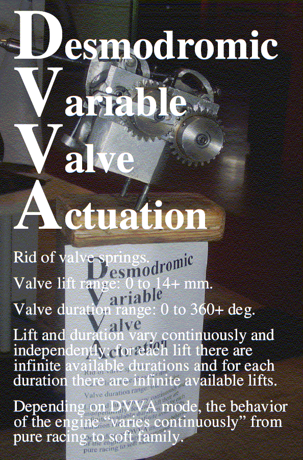

    the pattakon DVVA (Desmodromic Variable Valve Actuation) is by far better:
    It is the combination and evolution of both (rod-VVA and roller-VVA).
    For the Honda roller-VVA we had to pay 460Euros for a set of Toda, egg-shape, valve springs (they allow 12+mm valve lift (not possible with the original Honda B16A2 valve springs) and 9,000+rpm).
    The DVVA (more at http://www.pattakon.com/pattakonDesmo.htm ) :
    needs not restoring valve springs and is for way-higher-revs (provided the underneath mechanism (pistons, con-rods, crankshaft, block) can withstand the “punishment”).
    It is also “more variable” than the roller-VVA and the rod-VVA: the valve duration not only varies continuously from zero to a maximum, but it also varies independently from the valve lift (and vice-versa).
    Here they are shown some possible valve lift profiles:
    The DVVA is a pure mechanical Desmodromic Variable Valve Actuation system for poppet valve engines; more desmodromic than Ducati’s Desmo (which is non-variable) and way more variable than BMW's valvetronic, Toyota's valvematic, Nissan's VVEL, etc.
    Hello FastFred.
    You write:
    “I would love to know more, possibly some unpublished insights and pictures that have not been posted already on the Pattacon website.”
    Look at the above, poor quality, DVVA demonstration prototype.
    It was made by hand (only the two race-ways were cut in a CNC mill machine) a few days before the Engine Expo of 2008 (Stuttgart Germany).
    Here it is secured at the top of a pile, having a “crank” on the one “camshaft” (which is actually a “crankshaft”) and two levers for the control of the intake valves (the one for the valve duration, the other for the valve lift) and another two levers for the control of the exhaust valves.
    What the label doesn’t write is that everything varies “on the fly”.
