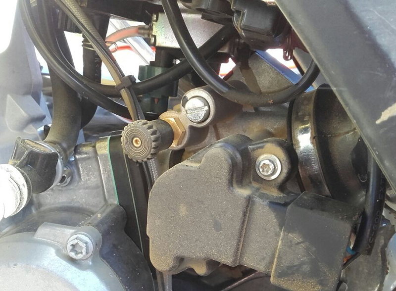

    Quote Originally Posted by teriks View Post
    My guess is that the oil line goes on the throttle body, and that the pipe on the cylinder is indeed a pressure senor feed.
    Attachment 330958
    Confirmed here.
    Oil pump looks like the same as the Aprilia ditech.
    I wish I had the smarts/time to write 2 stroke specific firmware for my ecu. Oil pump output would be awesome.
    Attachment 330958
    http://dirtbiketest.com/fresh-dirt/k...tkrrbkFy6Ob.97
    KTM have patents so i guess we can search to see what their and Mikunis are in relation to it.
    I guess if people ran vastly different petrol/oil mixture rates that the fuel injection might get a bit befuddled.
    So the oil injection might be a work arround that.
    I do hope the fuel injection is not as prone to low speed flame outs as the Four stroke equivilents are.
