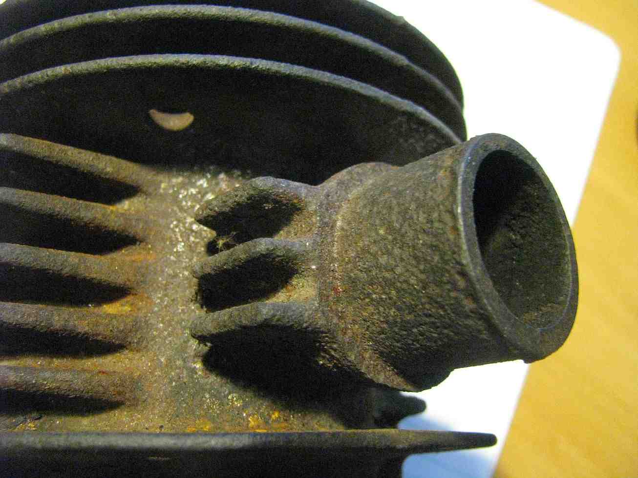

    With a bit more than an academic interest in exhaust duct cooling, I'm very interested in the potential value of a ceramic coated duct.
    In my simplistic approach to these things, it looks to me the the only real advantage to extensive water-cooling of the transfer duct is to provide thermal stability.
    Thus enabling "careful tuning" to control the point of detonation.
    The Negative to this heavy temperature management is removal of heat/energy from the exhaust pulse and the addition of heat to the charge in the duct.
    Plus the need to dispose of the captured (& wasted) heat/energy.
    As it has been determined, polishing the piston face, allows it to reflect, rather than absorb the heat of combustion.
    It follows (to me) that polishing the duct and header pipe should produce a similar result.
    Allowing hot exhaust to pass through without depositing heat AND allow cool transfer charge to enter and leave without picking up extra heat (Win-Win?)
    Polishing ducts and headers could, perhaps, also be simulated by a process something like this...
    It's smooth & shiny, contains silver and is highly heat reflective.
    It is claimed to reduce the external temperature of headers by around 150C. AND that's After heating the steel tube from the inside.
    So the heat reflection is internal at the steel to coating junction. Heat reflection without the physical conduction could/should be much higher(?)
    Might be just speculation & wishful thinking......or the next Great Step Forward in 2 stroke technology & performance.
    Cheers, Daryl.
