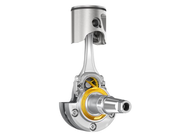

    Imagine a modern 250 or 300 enduro engine, the ktm TPI which has Fletner type injection, oil injection but sadly enough limited to the throttle body, and a balance shaft. If this engine could be equiped with a BRP E-TEC 850 oil pump, and a crankshaft with rollers like in this engine we would then have a MX engine with four stroke reliability for the crankshaft.
    Wobbly told us that a ktm 250 can be tuned to 65+ HP but when revved to 11.000 rpm the engine needs frequent maintenance. I wonder if an E-Tec type of crankshaft + forced oiling system could overcome that handicap and make the engine more reliable.
    The electronic oil pump is not cheap, 370 dollar, but the specific crankshaft of the E-Tec is expensive to the extreme. 2900 dollar
    Not sure if this is because it is made of unobtanium or some form of extra terrestrial metalurgy or just greed from BRP...
