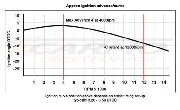

    Just looked at PowerDyno for RD/LC/TZ - wouldnt run it if they gave at away.
    2* of retard from 6 to 12,000 - joke.
  8. #32393
    12,343
    This is the trace i have seen for the race ignition ie no lighting Vape ie formally called Dowerdyno
    Oh you are right. they use the same unit and curve for all their race ignitions it seems.
    Rex caunt is back in business they used to maake an race only ignition for the Yamaha twins
Name:	Rex Caunt.JPG
