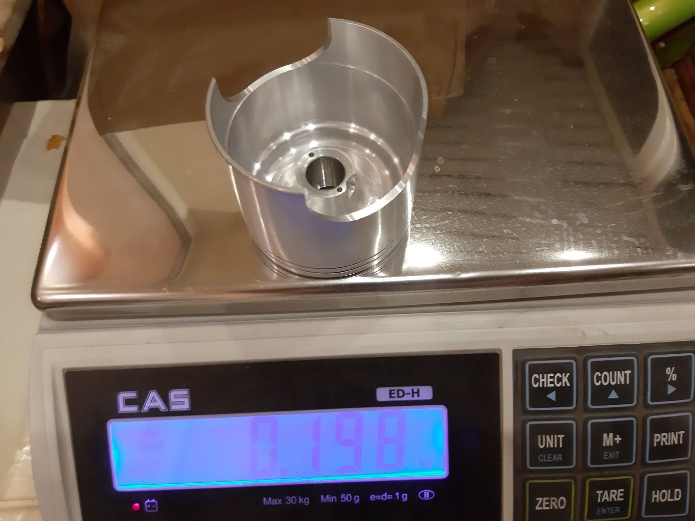

  4. #33484
    3rd May 2017 - 04:03
    1997 Yamaha rd 350
    Russia
    181
    CreizKopf
    Milling new piston for kreuzcopf engine (rougly Ryger)
    76mm external diameter.
    Hope with new pistons engine would start easier than now.
