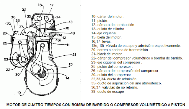

    Can you tell me some 4S engine that uses piston pump supercharging.
    At 2S we all know that they were serially produced by a certain brand and for a few decades
  10. #33640

    Quote Originally Posted by ceci View Post
    This probably doesn't really help in answering your question of course! .... but the piston type compressor was used on quite a few successful two stroke engines based on (relying on my memory here) Ricardo's "Dolphin" V2 layout ie Power cylinder/compressor cylinder arranged as a V twin) this engine appeared around 100 years ago, and I think was also used in fishing boats.
    https://www.kiwibiker.co.nz/forums/a...4&d=1586821782
    This layout was also used successfully in the Trojan light delivery truck in Britain - I think a V4 - it also used 'split single' layout) - however, basically the Dolphin layout).
    https://www.kiwibiker.co.nz/forums/a...5&d=1586821791
