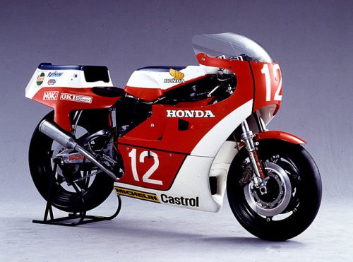

    Interesting that for Daytona race Honda prepared big bore versions, NR 600 cc for the race and later with two stroke NS 550 cc. But F. Spencer use NS 550 only for practice and used 500 cc for the race.
    Other very interesting Honda engine was 250 cc tandem for CR (RC) 250 prototype, or idea of oval piston for two stroke.
    Honda may have tried too many things at once - 16" wheels, monocoque frame making it hard to work on, probably other things as well.
    Other very interesting Honda engine was 250 cc tandem for CR (RC) 250 prototype, or idea of oval piston for two-stroke.
    They also built a turbo 250 oval piston for Freddy to try out couldn't convince the rule-makers to change the rules to allow turbos. Although Freddie tried it in practice.

    the line drawing most say was for the round piston twin but note the gear driven cams
    They then built a conventional round piston 250 kind of based on the VT250 with twin turbos that made over 100hp. Some say 150
    Honda's web site
    The NR250 Turbo was half an NR500 with twin turbochargers one for each cylinder and PCM-FI injection.
    It was to replace the NR500 for Grand Prix racing. In 1983, it made 153 PS (150 HP) at 18500 RPM and 2.0 Bar pressure. Due to turbo lag (and rules changes) it never made it to the track.
    The VT250RT made 150 PS (148 HP) at 11500 RPM and weighed approx. 375 lbs.
    Honda found the VT250RT turbo came on boost at 7500 RPM and accelerated at twice the rate of the NS500.
    Honda decided the power band was way too peaky for the rider to handle, de-tuned the engine to 90 PS (89 HP) at 11500 and wanted to put it into the 1985 Japanese model catalog as the VT250FTC, but was denied permission by the government.
    Honda through a heap of graduate students at the Nr project to try new things composites USD forks side radiator small wheels, slipper clutches, carbon brakes, separate spring forks carbon frames etc.
    Most were used later on the V fours.
