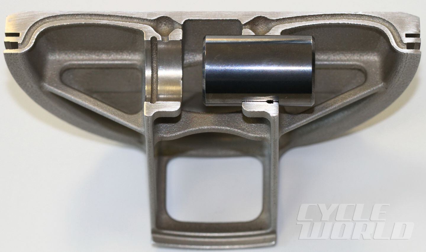

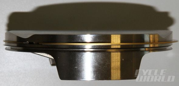

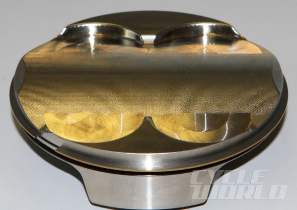

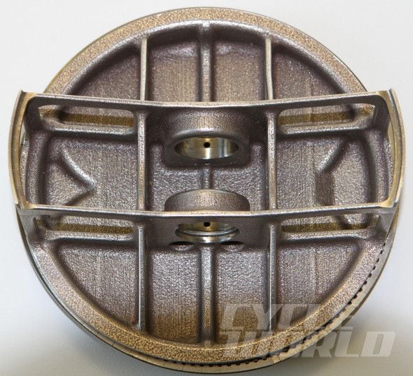

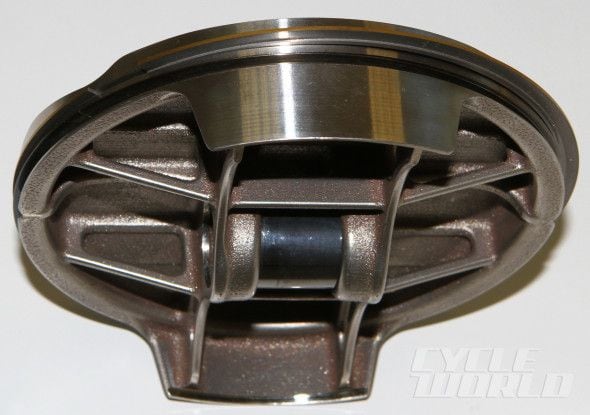

  10. #35995
    12,345
    Didn't Frits post a pic of a Ducati piston some time back which was a beautifully delicate steel piece ? Memory says that in those bore sizes and RPM the strength/weight calculation favoured steel
    I'd suspect that a coating of something like tin - or flash plated aluminium - would work well enough in nicasil.
    I recommend a warm drink at night for you Neil. And of course dreams which feature working schematics of uniflow engines.....
    https://www.cycleworld.com/2016/01/1...ology-feature/

    4,242
    Kentastic had designed something very similar ( in aluminium ) for KZ2 some time ago , sadly having a business that makes money is strangely more important.
    Cant believe how cool that tiny small end pin is.

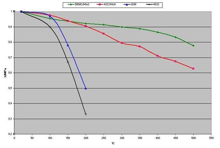

    Sweden
    92
    Steel pistons? Or a screw together composite piston? How well does steel wear against Nikasil? Should a steel piston be hard chromed and ground after? Or Nitrided?
    This is what keeps me up at night.
    With CNC it could be machined out to a similar weight as aluminium, certainly similar as a forged alloy piston.
    Here is a link to a sae pre-view for a two stroke steel aluminium hybrid piston
    https://www.sae.org/publications/tec...-0508/preview/
