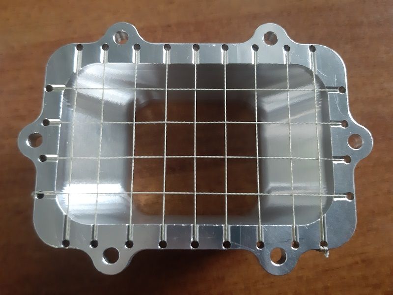

    Meshin reed valve
    Installed mesh in reed valve housing to dont allow broken petals damage engine
    Seems should not affect power
  14. #38864
    25th March 2004 - 17:22
    Wellington. . ok the hutt
    21,869
    Is that a real problem? Especially with Fibre based reeds.
    He's the only one I've got.
