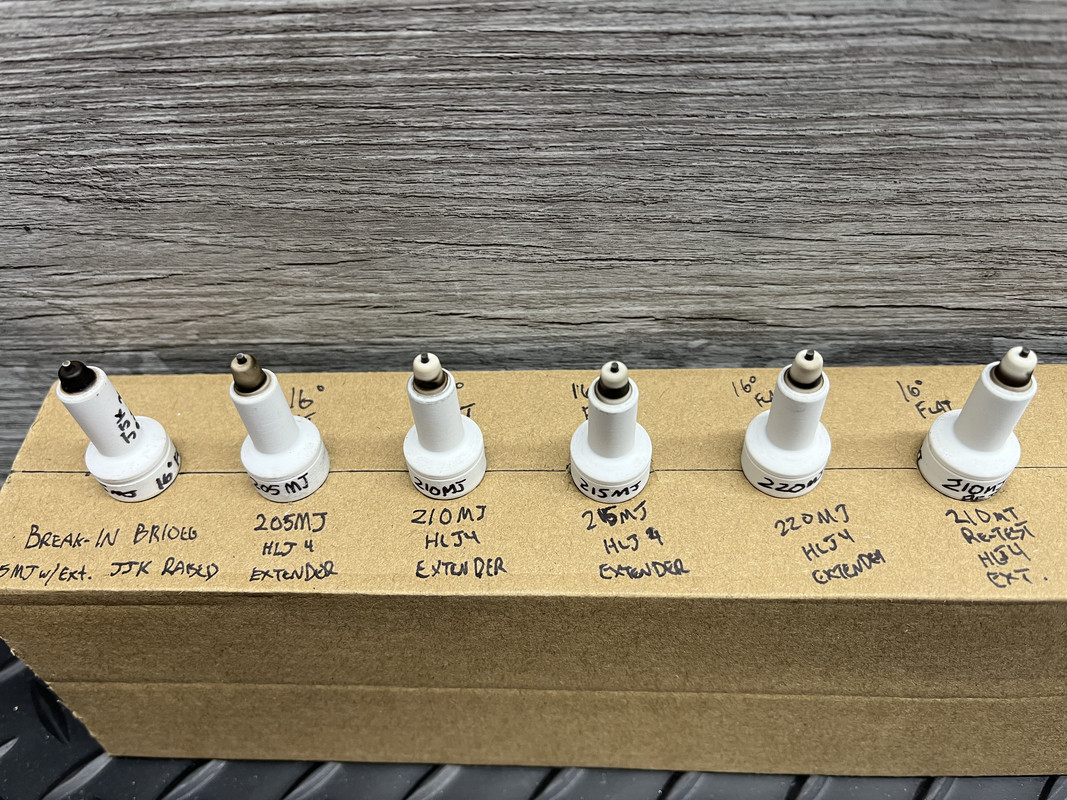

    These are plug chops before the main jet extender, where you can see the mix ring disappearing as I went larger. Note : these are not test pass and immediate plug removal. I don't have a track or great spot to use regularly, so these all include a few miles to/from the spot at low throttle, but they seem to tell the story regardless.
    These were after the main jet extender. I think the 220 has less of a mix ring due to washing. The other guys with my setup are 175-195MJ so that's getting to be a lot of fuel. What's odd is that it ran the best time on one pass with the 220. For some reason the 210 acted very rich, with lower RPM and EGT.
    L to R : Break-in ride (new ring), 205, 210, 215, 220, 210 redo.

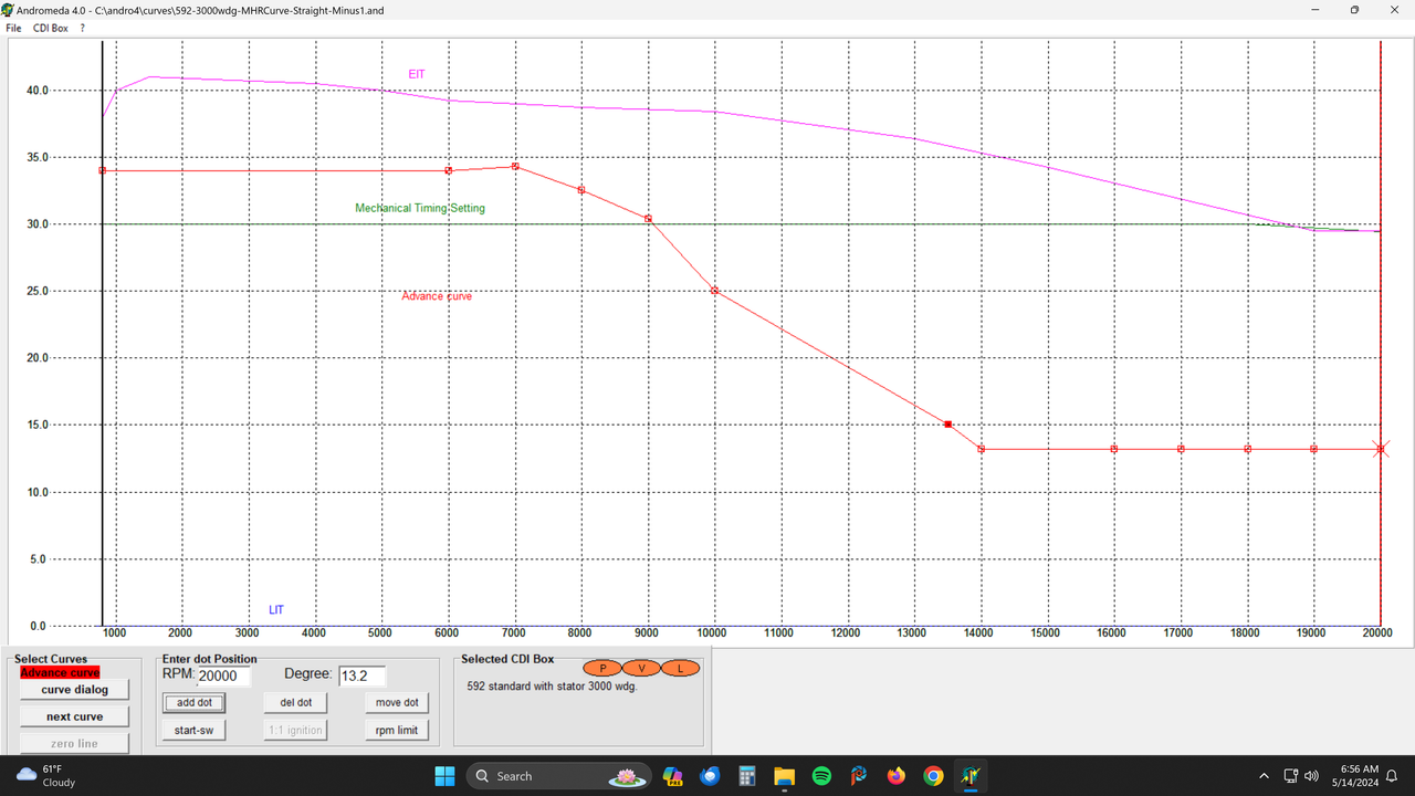

    The last tests that I did were with 16* flat and a sort of clone of the curve that the engine maker's ignition provides with slightly less timing between low and high rev because I was pretty sure I heard detonation on my way back from test runs at about 12,000RPM and low throttle. Here's that curve. I did notice that it looks like less fuel on the plug with the more standard curve vs the 16* flat. Also, it wants to foul plugs with 16* at low RPM.
    Man 1400* is insanely lean on any fuel - so something is very , very wrong - just the mere fact it goes there sends alarm bells about lack of compression or ignition , as well as the obvious fuel restriction scenarios.
