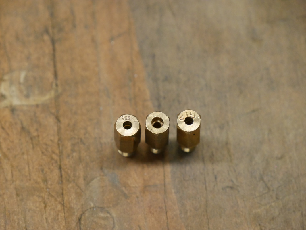

    Pretty sure I found why the 210 main jet acts totally different (richer) than the jets near it. These are Keihin jets, all ordered at the same time. The 210 has a large opening in the end. The orifice through was checked in the past and seems to be on par somewhere between 205 and 215. It's just the entrance that's bigger than every other jet I bought, Keihin or Stage6. Number stamp is on the side vs top like the others. Stamping size doesn't match on any of them.

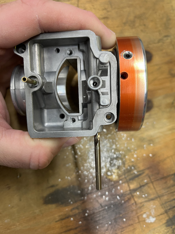

    Someone that saw my posts here was kind enough to email me a French language vid showing PWK mods for better fueling (linked below). I drilled out the cap covering it and then drilled the fuel passage headed to the needle area to 4mm. The holes around the float were enlarged to 2.5mm and the vent holes were done with a 3/32" bit. The fuel passage was sealed back off to the outside by tapping to M5x0.8 and installing a set screw with a very small amount of JB Weld on the threads to be sure it seals. The float needle chamber was deburred from drilling and polished with a Q-tip and aluminum polish.
    https://youtu.be/EFXFvepG59c?si=VlGWV0ExmHVGAEVd
    I also removed the float stop in the bowl. It lets the float open just a tiny bit more.
    I rechecked fuel flow and it went up to 560ml/min. That's almost a 37% increase!

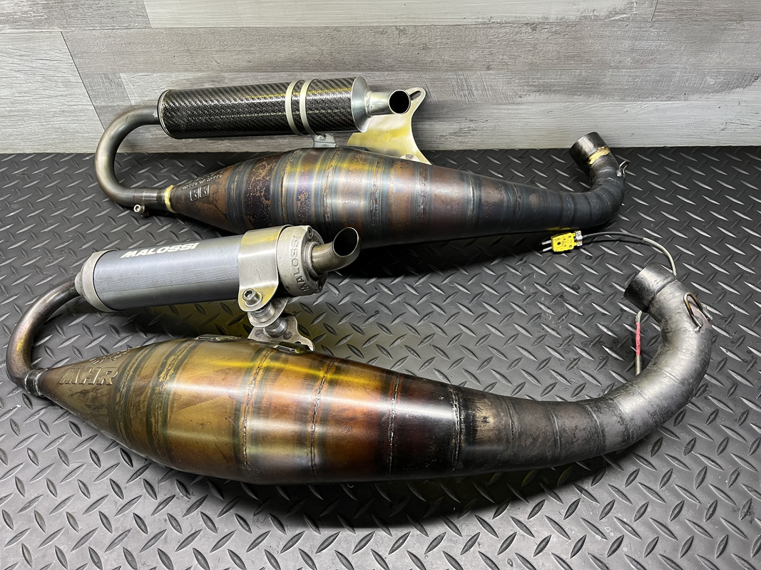

    F5 Dave asked about stinger size, so I checked the MHR 94cc pipe made for the RC-One and the Stage6 R/T 100 exhaust that I have. The MHR stinger is around 19mm. The S6 pipe is 22mm, but using a 20mm removable reducer. I have used the R/T 100 exhaust on this engine and it will allow more RPM, but 1/8 mile times are slower so I never actually use it.

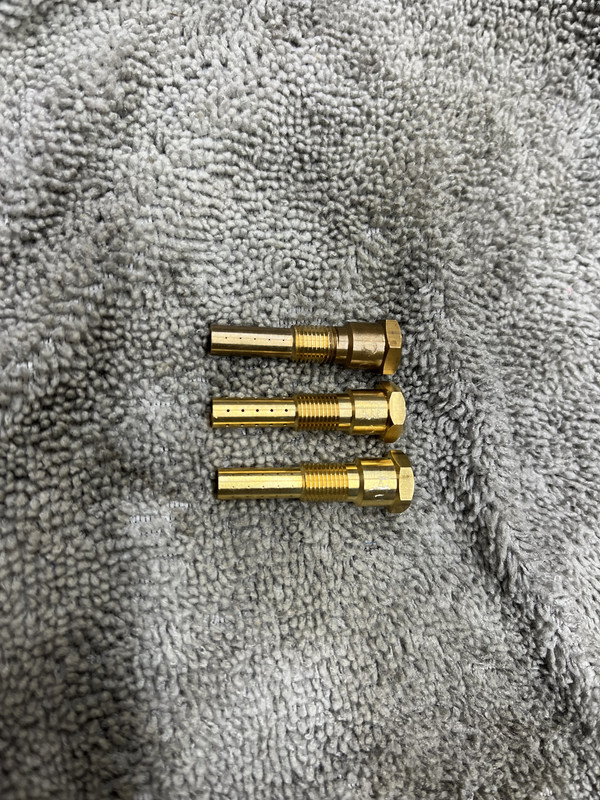

    Here are 20, 30 and 40 hole Polini atomizers. It's odd to me that the 20 and 40 have small holes and the 30 has large holes.
    I searched for info about atomizers, but it was contradictory in some cases and left me uncertain overall. I thought about it and assume that holes open to fuel will richen the mixture some and holes open to air will lean it out a little. If that's the case, I wondered how many holes were bathed in fuel.

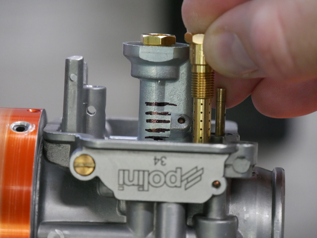

    I marked the carb where holes should be, height-wise. All of the atomizers match up, having 5 holes per column, just different amounts of rows.
    After more testing, I think 1 atomizer hole is in fuel. That's with the carb straight up. I would think if fuel drains at all, then the fuel bathed hole becomes another air entry and leans out to some degree. If that's the case, I still don't know if I want 20 small holes or 30 large ones. I didn't notice any obvious difference when I broke the original 30 hole and swapped in a 20. Some like to say no holes on a 2T atomizer, but I don't have a 0 hole atomizer and I don't know that trying to fill with solder would be wise.
    The atomizers are different IDs. About 2.71mm for the 20 and 40 hole and 2.76mm for the 30 hole. I don't have a really precise way to measure those, but somewhere in the ballpark and the 30 hole is definitely larger inside.

    First off the main jet issue.
    Having totally different entry geometry means that the actual flow rates will bear no relationship to each other.
    You will have to make a simple flow rig using a bottle with a hose connected to the jet, and flow a set amount of liquid over a time base to find out what is going on. But having differing venturi setups is a huge spanner in the works.
    I have never seen that in any other carb main jets, ever.

    I'd try running the bigger stinger pipe and see if that brings your temp down as an experiment.
    He's the only one I've got.

    Agreed with Dave. 19 mm stinger (plus added dp of the 180° pipe to the silencer) sounds quite critical for an engine that should easily produce 40 HP on the crank...
    It is. 40 crankshaft-HP requires a restrictor diameter (D5 in the drawing below) of at least 19,6 mm Ø.
    And that's just the restrictor; the stinger diameter D6 must be clearly larger than that.
