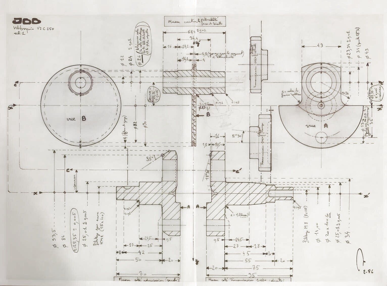

    Below is the JBB V90 crankshaft. I agree it's not very clear but it's the best I have.
Name:	JBB 250 latest crank design 1986.jpg

    V90 crankshaft
    Great Frits. I proceed your picture with artifical intelect software. Seems now more easy to work with.
