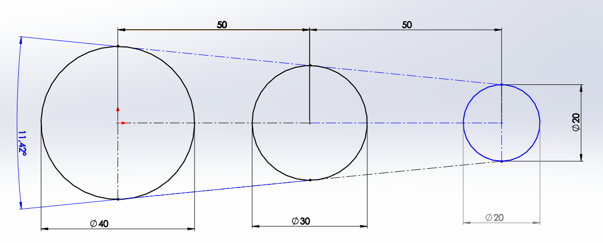

    when making angles in cones, is it more important to keep the angles of the cones the same, or the diameter at the angle, as keeping both is not possible.
    as an example, this cone will get a 45° angle in the middle (I know 45° is way too much, but the bigger the angle the clearer it is):

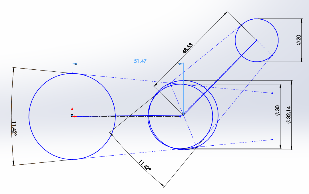

    keeping the diameter of 30 at the angle gives these angles :

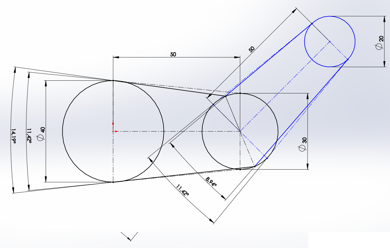

    when keeping the angles at 11.42°, the diameter get's bigger, and the lenghts of both parts changes (for making an angle in a cone this does not matter as the total length stays the same, but when making an angle between for example the last header-part and the first diffuser-part, it changes the length of both) :
    so who does what ? the pipes for my MX-moped are for the biggest part curves so it matters more than on straight pipes with just a few tight curves :

    I have been doing this in SolidWorks for over 25 years.
    When joining two different angled cones at their ends , you extend the cone length and create the cut passing thru the real end center points.
    Thus one side of each cut is shorter and smaller in diameter , the other side is longer and larger in diameter, but the centerline length says constant.
    Here I have joined two 2mm thick cones using this method, both cuts are 5* , and there is no discernable difference in the mating diameters at all.
    Ive done this literally hundreds of times , and never had any issues with the cones not mating exactly.
    The only other trick to doing it in CAD is to create the cones as a surface rotation that are driven by the neutral axis diameters ie the cones ID plus one material thickness.
    Thus when this surface with an angle cut is unrolled into a pattern , you do not have two distinct edges due to the angled material thickness.
    If you do dont do this you cannot simply remove one of the lines for the laser to follow , as neither represent the true angled cut shape.
    so keeping the angles is the way to go, tnx

    Extending the cones past the end point and then cutting across the actual center point is the real trick.
