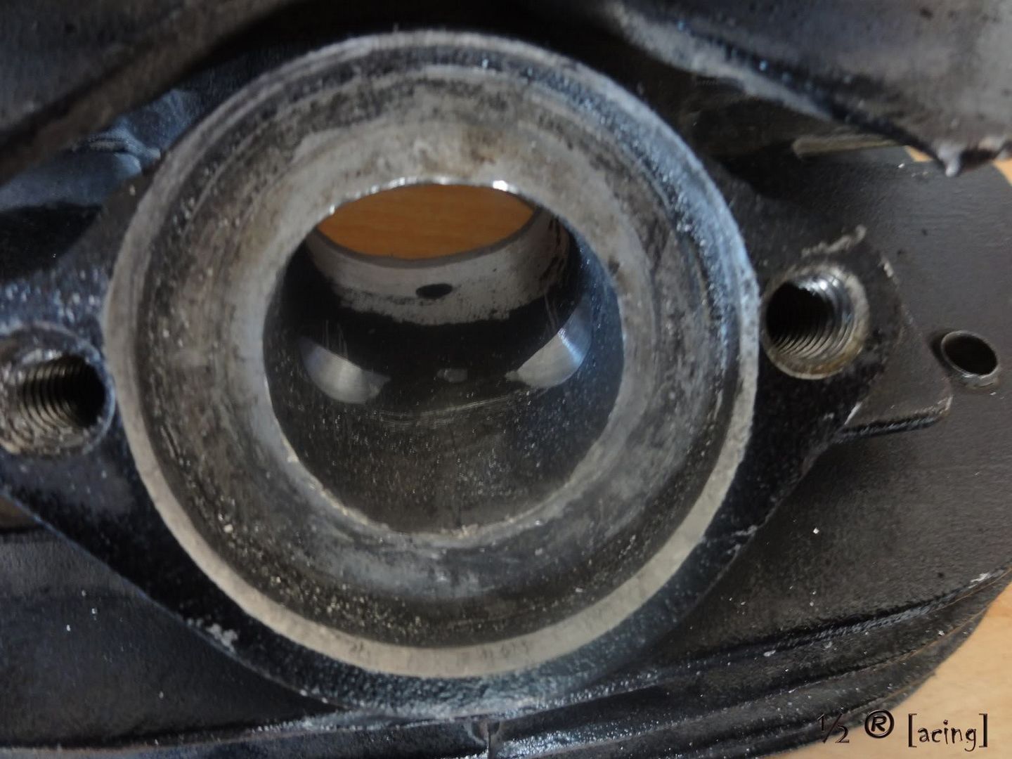

    I was trying to explore the effect of various nozzels at the exhaust port, thay are all 34mm and vary in the exit angle and length.
    They started at 5mm long out to 30 mm and the angles varied from 61-33-22 degree to 11 for the 30mm one.
    Now I am not sure if the change in overall tuned length was making the difference or the angle of the nozzel but food for thought.

    I got better results at first with the shorter nozzles, but I ended up trusting Wobbly's experience and left it at 30mm L. Then I tried to accomodate the length added by removing some mm's from where it would seem to matter the least in this testing. I think those points where the straight pipe I have before the header and the exhaust duct length.
    I shortened the former by 20mm and the later by 5mm (I do can actually dig 5mm in my duct, due to its shape). I ended up with pretty much the same results of the short nozzle.

    Hey TeeZee, I think what you are seeing is related to the fact that the sim cannot replicate the flow regime that an oval to round transition creates in the spigot.
    The wide oval shape, that keeps this width right thru to the header start,really promotes the flow from the top of a T or the tripples in that setup.
    But as I said at the start of your experiments I have not tested the relationships or area changes in a single port engine.
    My feeling is that just maybe a single port would "like"a small volume duct,and then a step at the header - as your short transitions seem to help top end, at the expense of some area under the curve leading up to peak though.
    I have asked Neels about the ideal way to model this as part of replicating a sliding header project I am working on ( as this has a step at the end of the header).
    You cant have a "zero length" step within the pipe, so I have asked him what to do.
    Will let you know the result.
