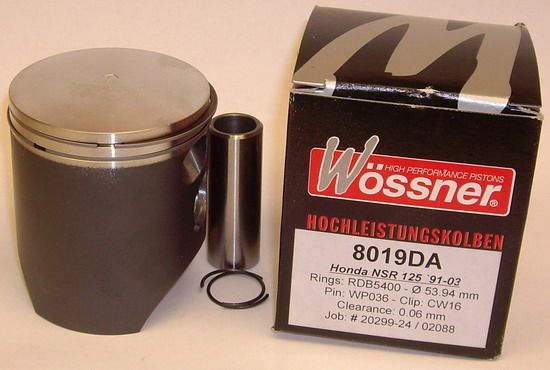

    Can you see Wob what the diff is between the gudgeon height on the CR80 50mm piston and the std NSR is?
    i had a look and it looked like it was nearly 6mm surely not?
    Wössner Forged piston fitting Honda NSR & CRM 125R 1991-2003
    The flask is available in five sizes, from standard to maximum TDC.
    53.94 53.95 53.96 54.44 54.94 mm.
    Height total of 64.40 mm.
    Height to the piston edge 62.00 mm
    Center piston pin to piston top edge of 30.00 mm.
    Center piston pin to the lower piston edge 32.00
    Piston Bolt Dimensions 16 x 45 mm.
    Two chromemolyringar height of 1 mm.
    Piston Ring Locking at 5 o'clock and 7th
    Cannon Piston for Honda CR-80 Years 86-02.
    The piston comes in two tolerances for bore 46 mm.
    Fitting 79 cc engine.
    Overall Height 53.25 mm.
    Height to the piston edge 51.10 mm.
    Center piston pin piston top edge of 24.10 mm.
    Center piston pin lower piston edge 27.00 mm.
    A piston ring chrome molybdenum 1.00 mm
    Piston ring lock 150 degrees from the exhaust port at 5 am.
    Piston Bolt 14 x 38.90 mm.
    I think that when undersizing the bore with a smaller piston, the number you should pay more attention to is the overall height. While you can rise piston position into the cylinder with a longer rod and/or base plate, if total H is less than the distance from deck to ex. floor (stroke+deck?), then ... Houston, we have a problem!
    Destroke as well as debore remenber i haven't got to the skirt yet.is that what you are meaning? total h? but yeah big diff there. but the cr ran a fairly long stroke.
