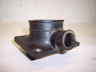

    With this & Frits advice on keeping the tract as short as I could(ish) I have flowed a control reedblock (the differing epoxy makes it look like there is a bad match but I used Kneedit as its easy to form & then Devcon over the top to smooth it out. Then I ground & sanded it back. Needs more but will do for now. Next block will incorporate a fin & test against this one.
    But then I measure it & it is 160mm from reed tip to bellmouth (photo makes it hard to see but it is squared up).
    I want to peak faster still than 12, probably 13,000, but I'm no where near even 135mm to the Bell mouth. I could perhaps find a shorter manifold rubber, but only by a few mm & mill into the 10mm ally plate. But I'd only find 10mm tops. The manifold is only about 30mm long. Going to the 36mm PWK makes the assembly even longer.
    currently an early TZR block (only just fits) with VJ21 32mm Mik.
    I sent you a picture of a straight reed manifold from a YAM Phazer snowmobile that was shorter a while back.
    BOLT HOLES ON CENTER: WIDTH = 70MM, HEIGHT = 57.5MM
    Also if there is enough meat in the RGV carb the spigot recess could be moved inwards like on a TZR250 TMSS28 carb vs STD Mikuni VM
    Then the rubber shortened with a scalpel
    But i have seen a thread some where that shows how to make a rubber manifold as on the Japanese bikes do.
    Can't remember where, ....OK not the one but like this anyway
    http://www.precisiontradingsystems.com/inlet_videos.htm
    Failing that you could replicate a old Amal or four stroke flange mount cemented direct to the carb with a thin insulting piece.
    Much like a MB100 or RD125/200 or Suzuki RG500
    There is a Short PWK 36 from the KX125 from around 99 ish but i guess that's what you may already have?
    These are 73mm long overall as opposed to 91mm for the std large Keihin PWK.
    (Yes have to be modded to suit the angle But Wob has outlined this before)
    As a comparison the TA22 Keihin from a NSR250 is about 95mm.
    So what are the Mikunis from the VJ21?

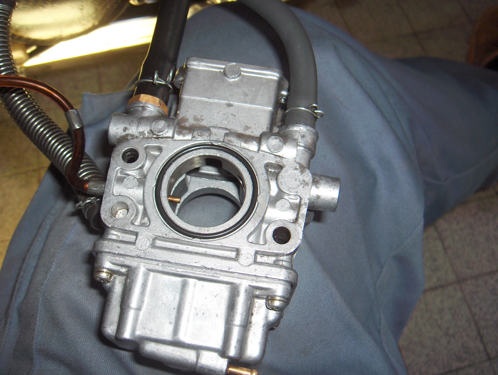

    Thanks Husi, but that Yam one doesn't look any shorter, except maybe the plate, but I could take that down, but I'm not going to find 25mm. Rubber is needed to isolate from vibes. Just checking if that really meant 135 to the bellmouth which is tricky.
    He's the only one I've got.
  9. #8664
    12,286
    So what is the RGV carb length? is your PWK a shorty?
    A long while back i posted a length of inlet rubbers its on a decade page somewhere.http://www.allensperformance.co.uk/p...manifolds.html
    but the inlet rubber of the Phazer looks shorter than just your inlet rubber (which acually looks long).
    Re the inlet vibes the RG500 and RD200 seem to cope? As Mike said the Vforce seems shorter. I am sure Frits said somewhere if the tract is smaller it can be longer I think? assuming the length Wob posted is to do with the Helmoltz frequency?
    Mr Frits..... But I claim that in a normal reed-valved engine you have no real Helmholtz frequency; once the flow direction wants to reverse, it is blocked by the reed. It would be the same as a brake that stops the bouncing mass in your animation once it has reached its highest position.
    Only two things can go wrong in a reed-valve engine. With too low a Helmholtz frequency the mixture column in the intake tract has no chance to convert all of its kinetic energy into pressure before the next cycle starts. Or the frequency can be so high that the flow already reverses before the crankcase volume has reached its maximum value (piston in TDC). Between these two extremes there is a broad frequency range that functions well in combination with reed valves......... We need a certain Helmholtz frequency, but there are several ways to achieve it:
    via the volume, via the tract length and via the tract diameter.
    OK maybe not so sure but i did have a Question mark
    And I am sure I didn't. Quite the opposite in fact: if the tract diameter has to be small for some reason (rules), you can diminish its negative effect by making it as short as possible.
    Can you expand on the text i misquoted Frits?
    "Frits Overmars"
    PS your carb looks a lot like a Suzuki one in profile rather than design
ID:	268079   Click image for larger version.
Name:	Rg250 vs RG500 carbs.JPG
