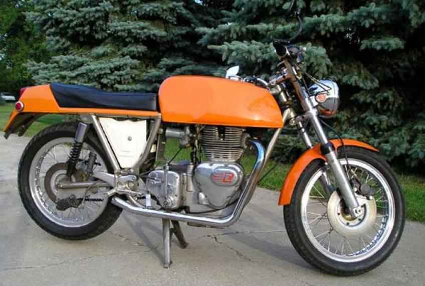

    Most of us here in the South Island would have seen and heard this unique New Zealand Home brewed special
    (Both the frequency and the amplitude are pretty unforgettable)
    But i guess it might be interesting to the northerners.
    George Begg's factory/Workshop must have been an exciting place to be after hours what with the construction of the F5000 cars and Burt Munro dropping in to borrow the use of equipment and materials and with specials such as this.
    i had posted this before.
    The Begg workshop was obviously a hot bed of special building.
