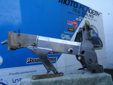

    Open question to crazyman
    How much to mount the MC16 frames Rob has in your frame jig and reconfigure to NX4 geometry.......
    Not that i don't think the CVT could be excellent.
    just wondering..........
    nice to know the angle from the frame rails to the fork head ? maybe close as it stands if it had the same lenth forks as a rs in it.. so would end up most the work would be in the swing arm pivit

    Quote Originally Posted by crazy man View Post
    Yeah from memory the mc16 fork are fairly short (but probably very much longer than a NF4 STD) but the head angle is way lazy as std on the MC16.
    the major is taking out the extra 3 or so inches of spar length head angle can be tidied up with incerts if nes (as the head bearings are beafy)
    it was an impossible to answer question.
    My plan before i brought the NF4 frame.
    was just to flip a nx4 frame upside down get the head angle positioned at ninety degrees the make another two vertical posts that would have a hole drilled for the position of the swingarm pivot.
    then position the nsr frame in the basic jig upside down off course and hack out the spars to suit if that makes sense.
    but seeing as you already have a substantial jig...................
    the jig would look kind of like this only not be a pushbike and be upside down
    I would assume that acuallly fairly close to how the Japanese actually manufacture the frames after the intitial frame is built.
    maybe sir Stephen (our Japanese based corespondent) can confirm this
Name:	lazy man production jig.JPG
    Mindful of the parallax error.
Name:	Frame Head Angles 006.jpg
ID:	273919 Click image for larger version.
Name:	Frame Head Angles 007.jpg
ID:	273920 Zero for an early RS
Name:	Frame Head Angles 010.jpg
ID:	273921 Click image for larger version.
Name:	Frame Head Angles 005.jpg
ID:	273918 7 deg for a NF4
Name:	Frame Head Angles 012.jpg
ID:	273922 Click image for larger version.
Name:	Frame Head Angles 013.jpg
ID:	273917 5 deg for a MC16
    It is the MC16 frame I am going to use. I have a complete RS250 front end for it and a magnesim 3.5x17 front for the rear and a light weight RS125 copy tank so I hope to be able to keep the weight down.
    matches this representation of a MC? not sure which model but i will check....looks like mc18 from here which is well worth a look at the blog.....
    http://edetuckracing.blogspot.co.nz/
Name:	NSR250 frame 2.JPG
