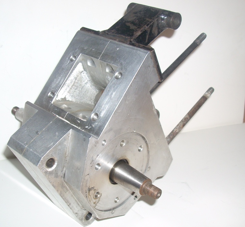

Name:	Engine Block.jpg
    Ok so that mounting is where they swing the engine assembly from.
