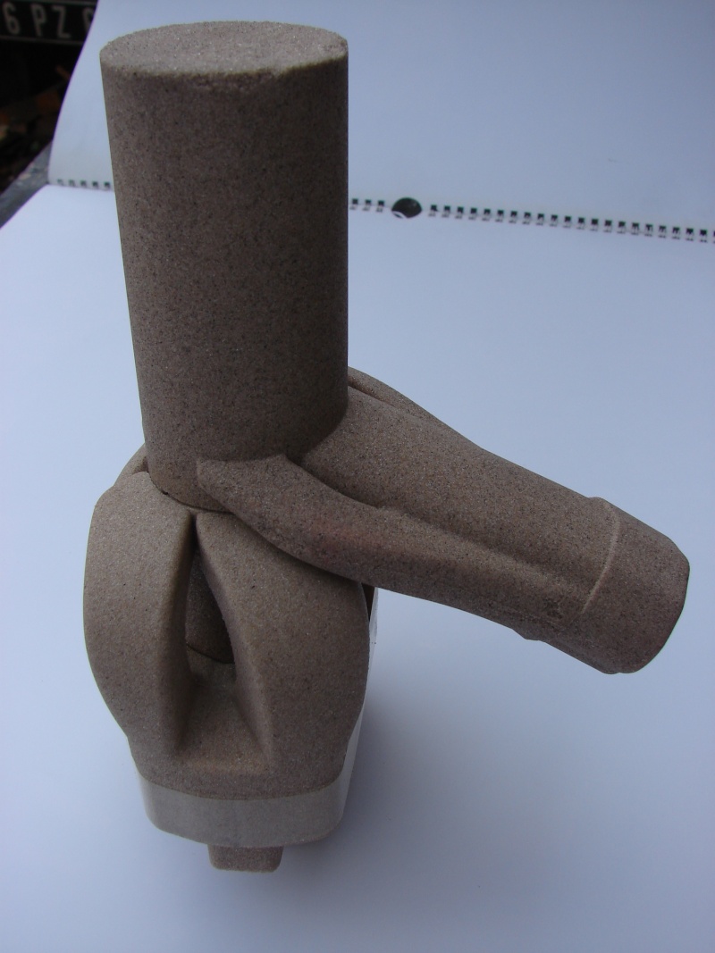

    http://sharkshifter.com/zc/index.php...ort=20a&page=3
    above is a random link not the TZ one
    depending on your set up you may need to remove an extra http://
    this triple port seems to be a great idea mmmmmm.......I wonder if it will catch on..................Maybe next week.
