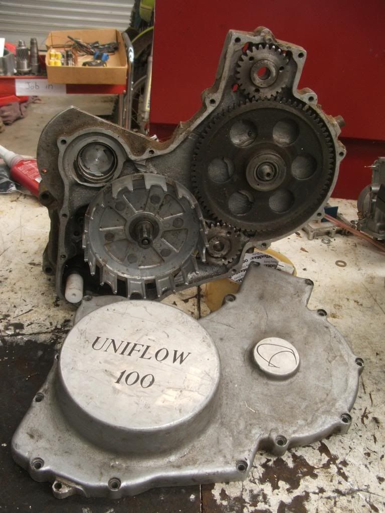

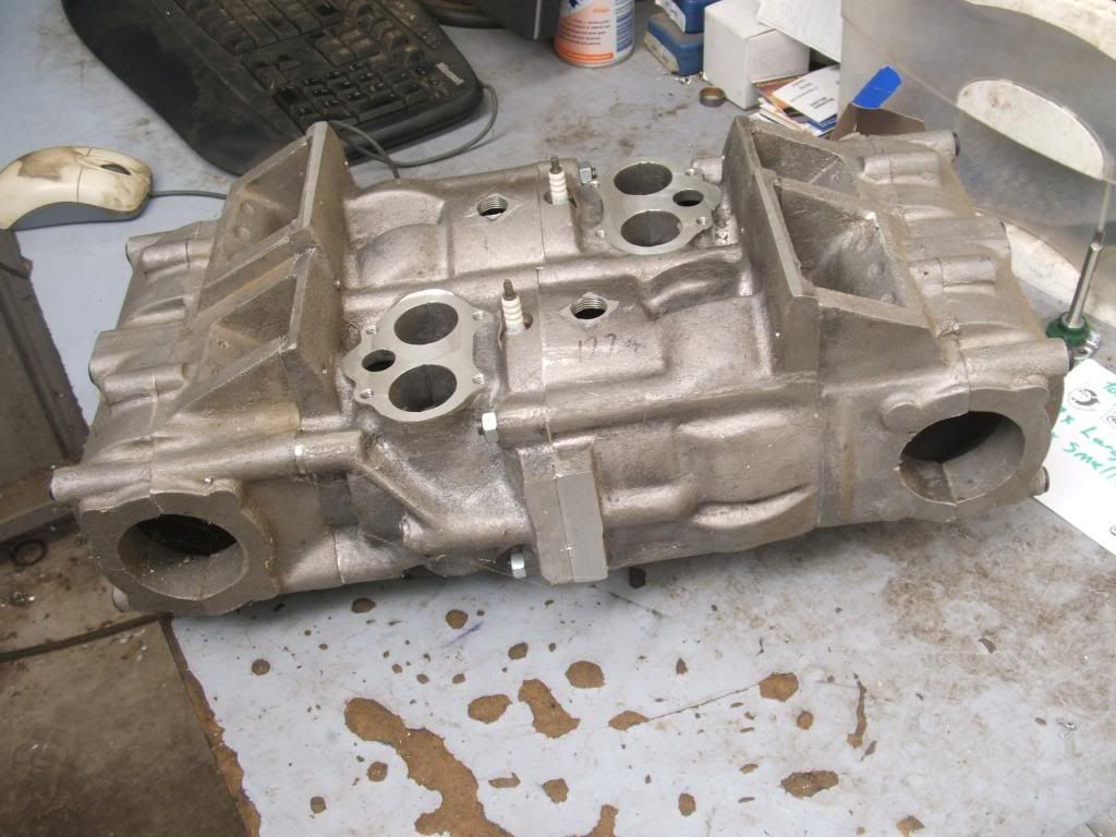

    More uniflow 100 pictures, drive side.
    New 650 engine castings,

    10,590
    Thats interesting stuff, I am very impressed with the castings.
