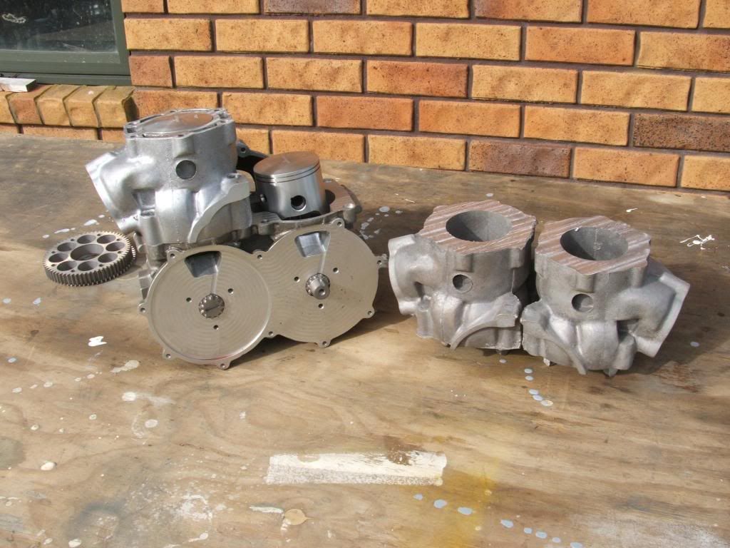

  5. #10805
    12,366
    Why are the cylinders offset like this? sideways.
    Husaburg, have you got your stuff now? Can I see it?
    Yes stuff is sorted and yes of course, i will take some pics today. (the camera is all sorted too i think?)
    here is a preview.
    It also looks like the local floundowndry is also better equipped than i initially assumed as well .

    Lozza, finally got time to finish the drum for the YZ 250 EFI project. Had the CNC shell the component to 2mm thick.

    Bloody hell Neil that looks awesome. The shaft on either end looks to be interpolated out how were you holding it?
