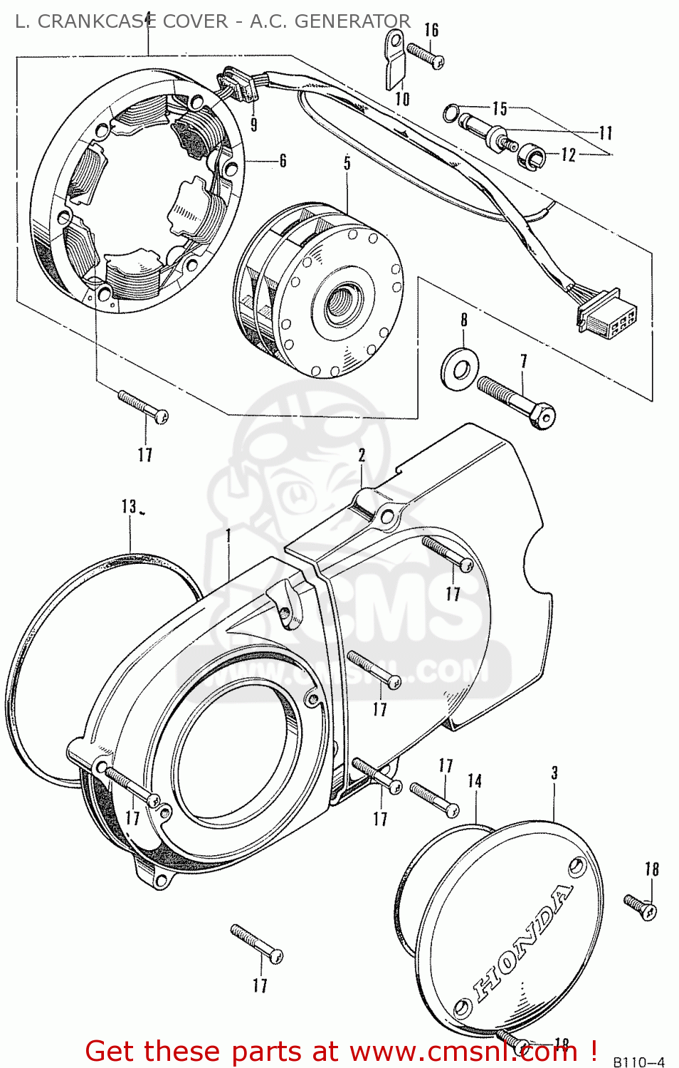

    Although (i think) 6 volt and i don't think 3 phase the CB100 rotor stator is tiny 75mm ish with a bit of work....Mabye the last ones in the UK in the 80's were 12V cb100n
    The Cb175 i think is 12 volt and 3 phase and also smallish.
    I guess a lot of the Scooters have decent 12v set up these days.
    but how much does it need i guess it is at least 3 amps on the pump?
    The Aprilia RSA sure looks looks tiny.........
