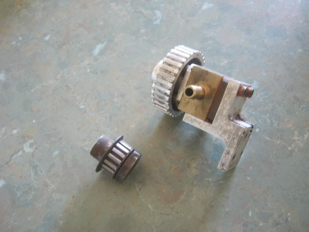

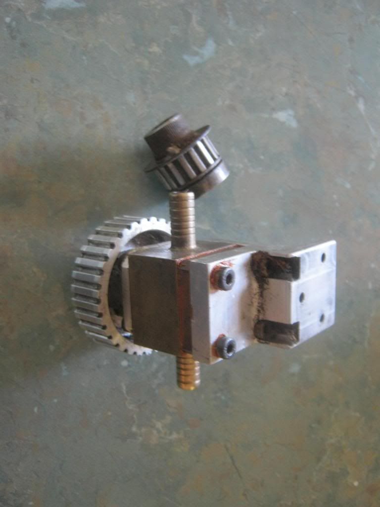

    This was my E90 pump, inside is a Honda 50 ( fourstroke ) oil pump element running in an alloy bronze housing. I ran this off the outside of the flywheel with a small tooth belt. Fuel was regulated by a needle on the throttle slide. More revs, more fuel pressure.

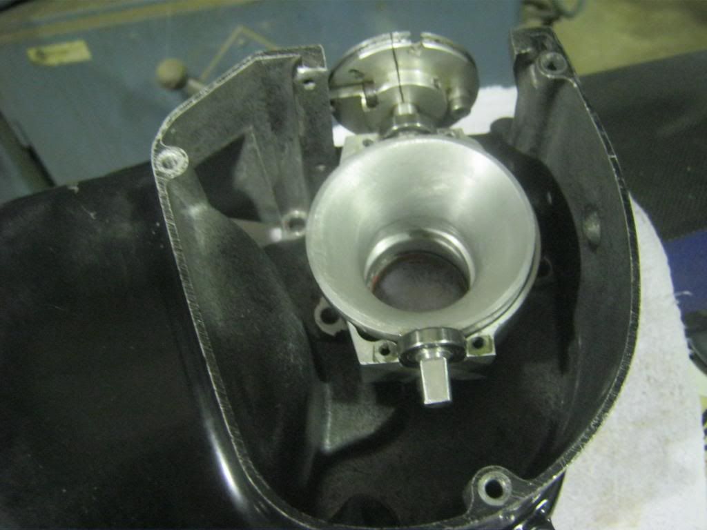

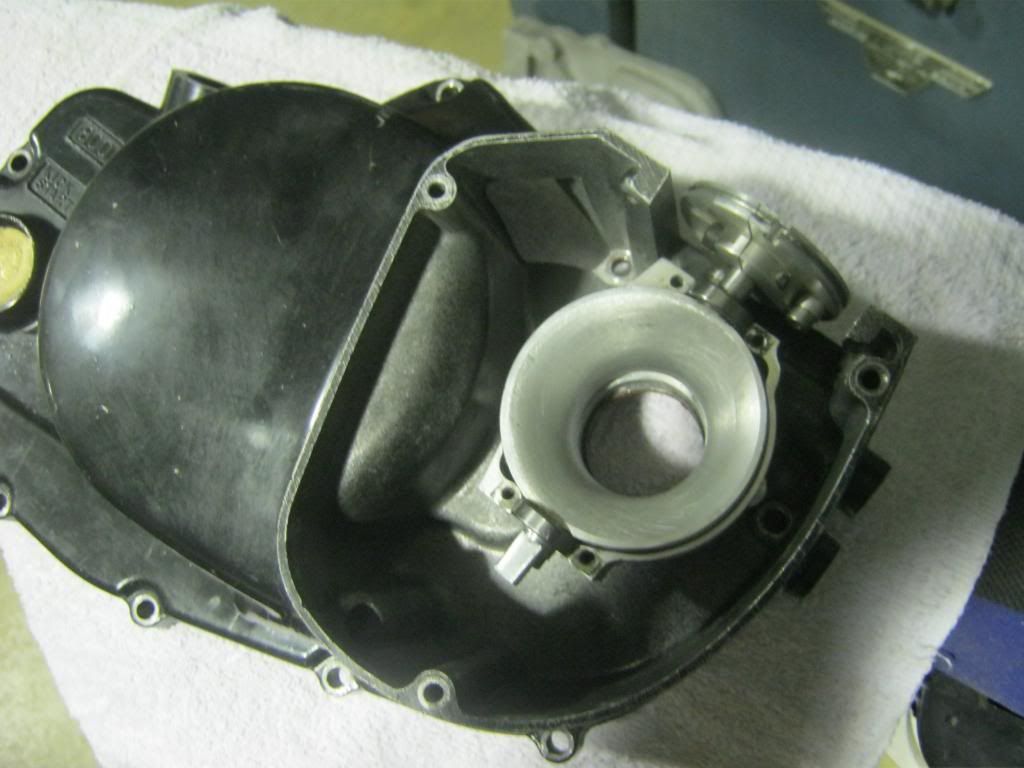

    TZ, is this what you had in mind?
  10. #11275
    18th May 2007 - 20:23
    10,592
    Yes that looks excellent, I will be able to make a top hat cover for the plenum with the control cables running through it for the ball valve.

    Frits, I don't think Rob's computer will " fly by wire " the throttle. The Link will.
    Best to just copy the F9 for the minute, it works.
    I'm fitting this fly by wire throttle / variable valve cover to my new engine the 360 rotary valve but it might be a while yet, still making patterns for the cases. It will be using the Link Storm computer.
