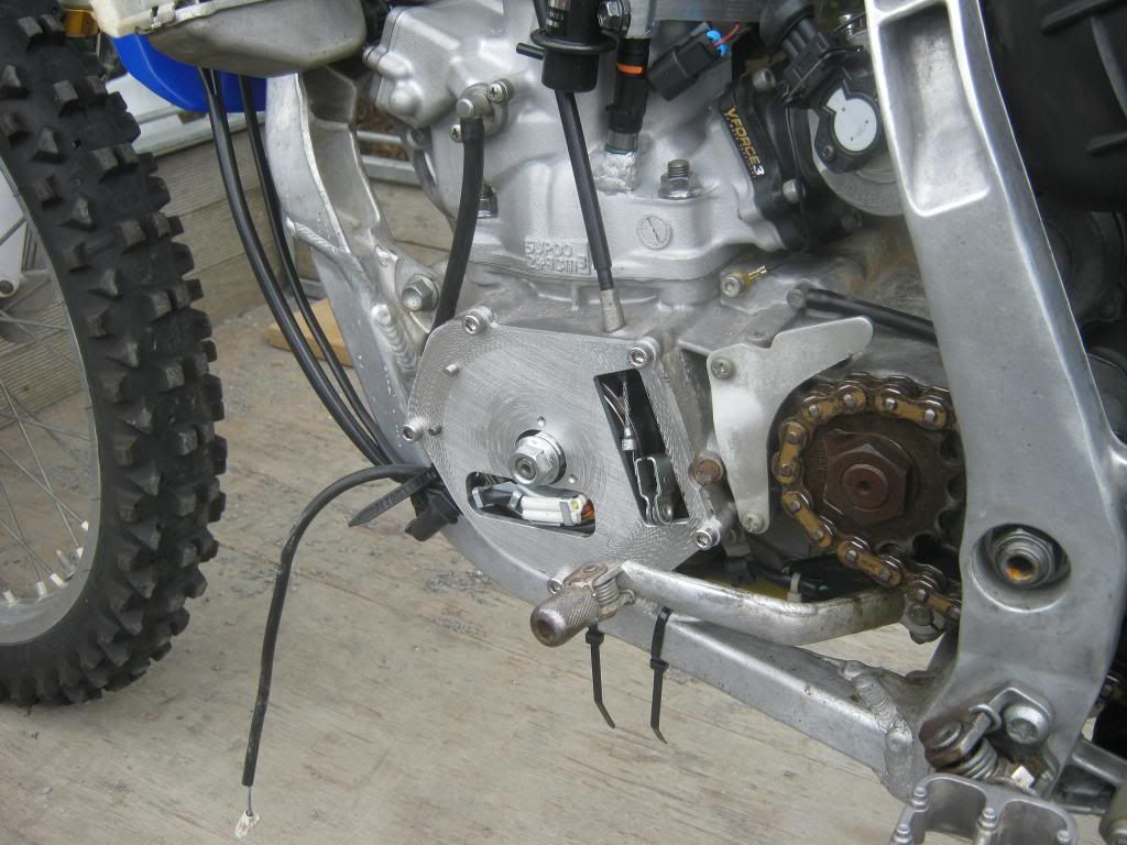

    The YZ 250 EFI peoject. Ready to run?

    No - fuel lines at least and a clutch would be nice too. The silver painted plasticine over the transfers gets a B minus.

    I wonder what the big end bearing has to say about the reduced lubrication and cooling.
    If you are as fast on the track as in the shop, I think you'll podium more or less every time.
    What's up with the ignition cover? -Does look a bit, unsealed, to me. If so, could get interesting in a mud race
    Love milled stuff. Also must show you how to resize pics hit reply with quote

    Yes, that bloody cover! The original plastic cover fits over this, covering everything, 4.5mm wider. This is using a 450F alternator. The customer already had the unit so it had to be fitted. It will work. Not as elegant as using an alternator shown earlier in this thread.
    Big end, if you look real hard there is a small port on the drum throttle valve to accept an oiler. We have a small solenoid pump that is computer controlled. There is a capscrew blocking the hole in the picture, behind the throttle cable.
    Big end cooling? we will have to see how that goes. My 350 has done 50 hours with no problems.
