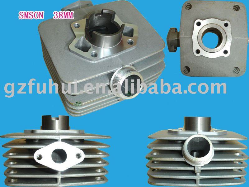

    I suppose you know the original 70cc simson cylinder which isn't a tuning-friendly thing. :-)
    12,5K rpm, 0,0175 ex TA (195 ex timing), also convenient (Blair suggests) Blowdown, Tr and Inlet Time Area. If I modernise everything I have to decrease the ex timing with max. 2-3 degrees to keep the suggested ex TA value.
    But regretfully it is hard to make such a perfect job by hand, as the bore 45 is too small and every single decimal mm counts!
