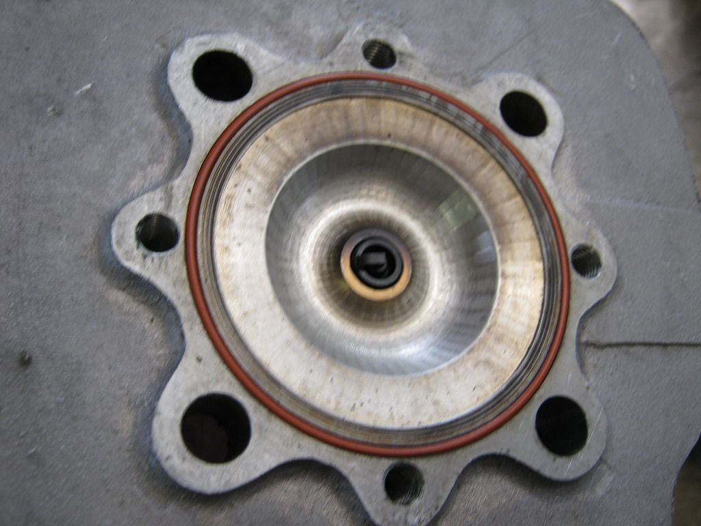

    Are you certain the head and cylinder were clamped up tight rather than the nuts being bottomed out? I ask because I had a similar issue lately and that's what it was. It's a pretty big blowout as well covering quite a bit of the bore circumference.
    Different head and head bolts so quite possible ....
  4. #11974
    16th December 2011 - 14:14
    Benelli 250 2C
    139
    I run "Viton" o-ring setup on an air-cooled twin for several seasons and never had a problem.
    Checking that the threads are not bottoming is a good thing to check as I don't think the problem is the o-ring. Also check that the tube bolts nuts not bottoming on the cylinder counter bores as this will seem if all is OK but the head won't be clamped down tight. Easy to fix - shorten the tube nuts a few mm's
    Yes the O ring has been reliable, its the composite head gaskets that failed and took the O ring with it. I think you may be right about the tube head bolts, I will have a good look tomorrow.

    Quote Originally Posted by speedpro View Post
Name:	TZ Head Bolts.jpg
    Yep your on the money. Rogue extra long cylinder head bolt got mixed in with the modified ones.
