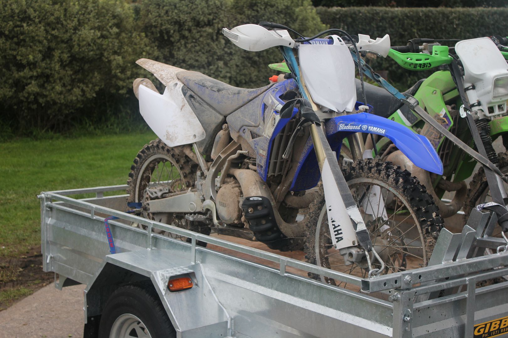

    Well had a good talk to Neil at the epic ride today. Good to see the Bighorn in the flesh and the YZ. Bit sodding wet though.
    He's the only one I've got.

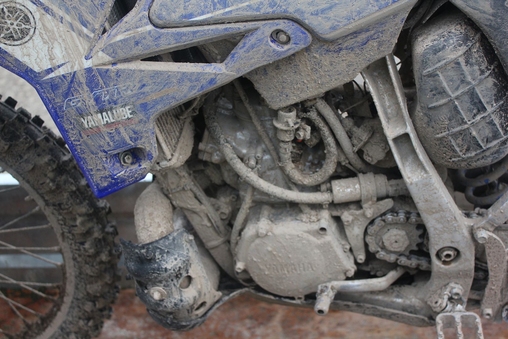

    Good to see you there F5 Dave, I didn't fire the Kawasaki up in the end, we just concentrated on testing the two YZ's. Then went home cold and wet! The EFI YZ goes real nice, smooth power output. I think I might like mine EFI as well now.
    Today the track was unbelievably well drained. Even got the sun out.

    F5 Dave, just knew we should have gone on Sunday! Had a good time anyway. Proved our point, 2T EFI works in the real world. Out of the four bikes we took only two had carburetors.
